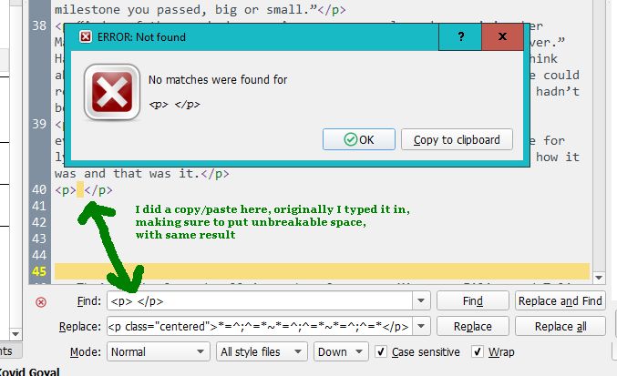

The oddest thing just happened when trying to do a Search & Replace.
I like to put in my own section breaks on fanfiction, so they are all uniform, so I copied what the author had in one particular area, but when I press 'find' I get that the item can't be found (attached below).
I've also completely retyped it in the text to see, copied and pasted, and it still won't find it. What have I missed that I can't see?? I also tried once with Regex selected, just in case, since that is an non-breaking space. I also changed the non-breaking space to a regular space, copied, and it doesn't want to find that either. Tried selecting to right after the closing tag, and selecting to the next line, and selecting to after the following sentence of text, all with no difference.
The only thing I haven't tried (that I can think of), is to close the editor and try again, which is my next step...Nope, same thing, tells me there are no matches.

Your image claims that you were searching only in style files.
Ugh, yes. I **think** it's because this image is after I tried different options, but decided against trying regex and current until after I asked, and I moved things around to hide most of the text (even if fanfiction and copyright issues are blurry, I didn't want to push it), but I can't be sure now. I know that when it worked for current, I undid it and tried again with all text, and it still didn't work, but now I can't for sure say how it was on the initial try.
I always double-check when things don't work (how many times I needed Regex and it was on Normal), so I'm *fairly* certain, just not positive anymore. Who knows, maybe my brain figured "not Current, not Marked, it's the right option."

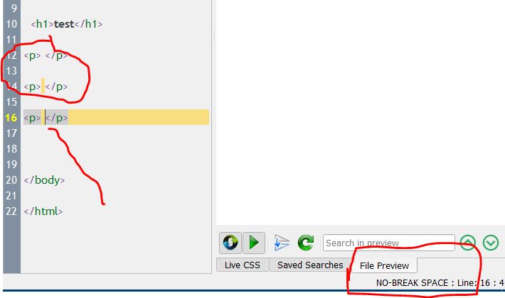

1. 'Special characters are tinted a little bit yellow (at least on my PC). If you look at the first and second <p> the space is tinted on the second since it's a non-breaking space
2. One thing that I find very helpful is the lower right box that tells me what the character just before the cursor really is.
