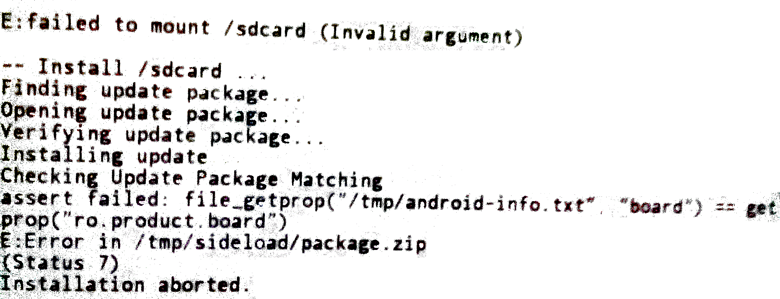

Where is more appropiate? Here?
I tried to install and gives me the following error...
There's a mess. The ereader-store.eu site says BOOX M96 Plus V1.7.4 rc1 is from 2015-12-11, the chinese site says is from 25-12-14 (2015-12-14_14-43_1.7.4_rc1_1c69455).
Is the chinese fversion newer? The last code suggest me it's a build from a source code repository. Is the code to build somewhere?

I'm downloading the firmware from the Chinese site. Unfortunately, it downloads damn slow...
