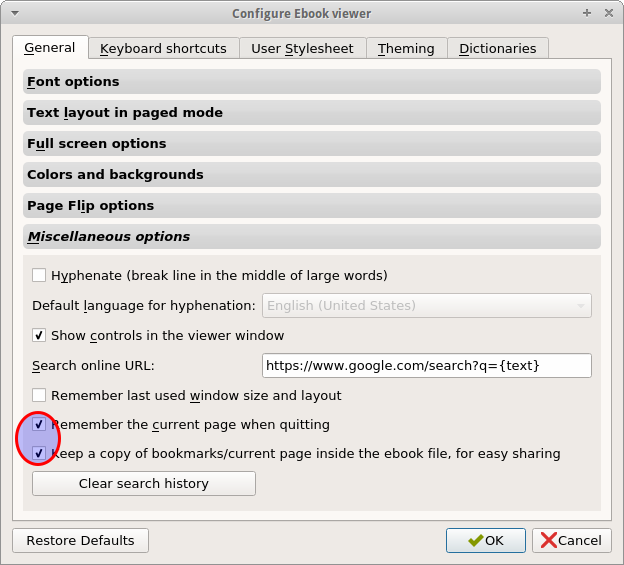

Well, I just tested it, and deleting iterator.pickle wipes away all bookmarks for me. Confirmed and thanks for encouraging me to field-test my theory.
But you do need to make sure it is not being saved inside calibre_bookmarks.txt
If either one is present, the bookmarks will still be there -- and they will get updated in both.
You can stop calibre from saving calibre_bookmarks.txt in the Viewer preferences
General ==> Miscellaneous options
Uncheck "Keep a copy of the bookmarks/current page inside the ebook file, for easy sharing"

Just to make sure, did you uncheck those two items (see image) in the viewer settings? If not, it will continue to open where you last closed.
If I have bookmarks I don't want/need, I just open 'show/hide bookmarks' in the viewer and delete them from there (I also delete in the file editor, but not sure if that's necessary, haven't tested that far).
Also, unless there's an option for it that I haven't seen, simply having a bookmark will not open the viewer at that location. Would be difficult when you have multiple bookmarks.
