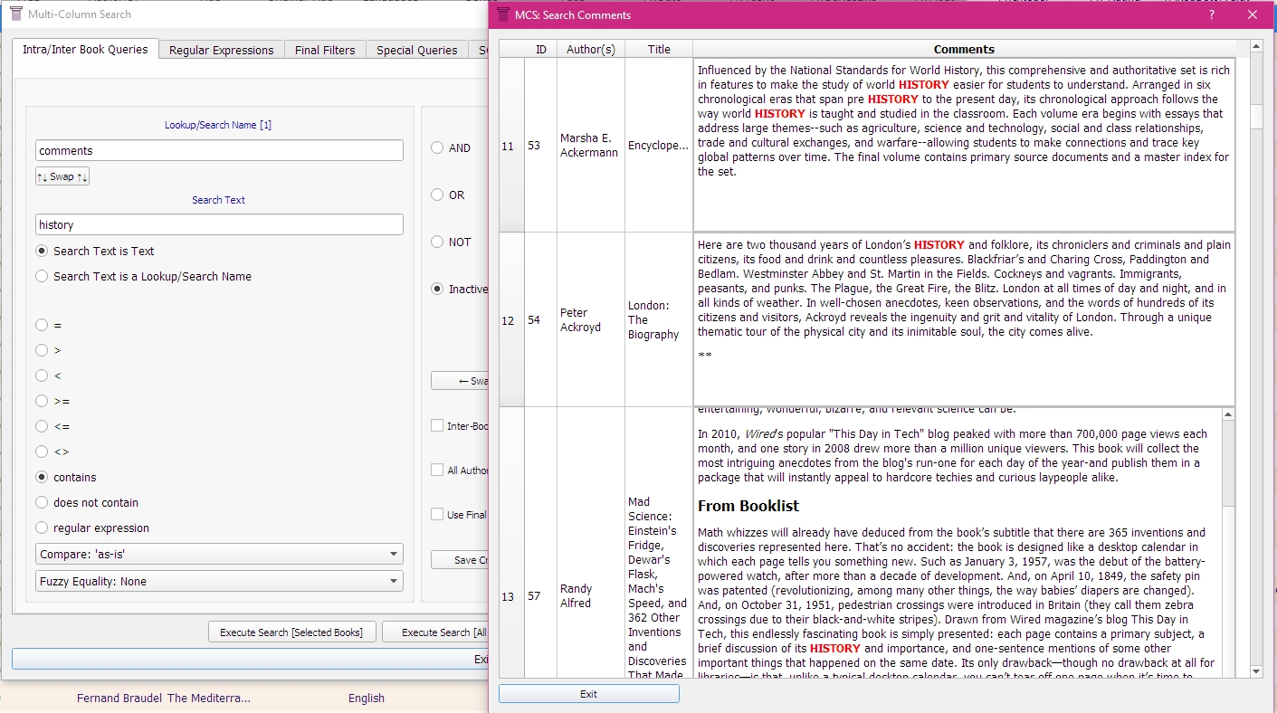

At the risk of asking the most stupid question ever: how to search in comments/comments-like fields? What's the easiest way to find particular words / strings of words?

The Multi-Column Search plug-in has special functionality for searching Comments, plus many search options.

No need for a plugin to construct the search for you:
comments:"some text"
See: https://manual.calibre-ebook.com/gui...arch-interface

@eschwartz, thanks! I was pretty sure there must be a simple way to do that, found all the information about how to look for books with empty 'comments' field etc. but somehow didn't stumble upon that!
@DaltonST, I keep your great plugin for more sophisticated missions .

@Joanna:
Using the SearchBar does not show you what you searched for. It just shows you the books containing that search argument. Subpar. I would never recommend it to anyone.
To actually see what comments you are searching for, use MCS. See the attached example. Calibre cannot do that.
DaltonsT
