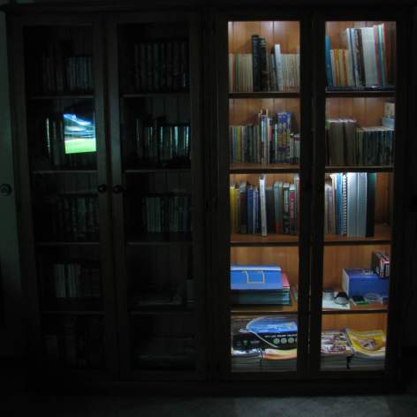

Clip-on lights for various devices are already available, most handheld gaming devices need them. From memory they work on anything from button cells to one or two AAA cells, and would be easily modified for Iliad use.
BTW, I'm lighting a glass-fronted bookcase, and settled on "medium" brightness LEDs in the 500mCd range. They have a spread of almost 180 degrees, rather than the 25 degree 10000mCd LEDs I'll be using for my camera ringlight. ;-)
Each shelf has four LEDs wired in parallel and set into a wood strip attached to the bottom of the shelf above. Each strip only draws 15mA, and it lights up the room at night.
The most difficult problem with these devices is not making them low power, it's getting the light spread and positioning right so it's useable. Most solutions tend to have a bright spot which falls off rapidly toward the edges. I've even seen a Nintendo DS light which uses a CCFL, to make the lens design easier.

Originally Posted by astfgl
...I'm lighting a glass-fronted bookcase....
That bookcase looks sweet, astfgl!
Thanks for the details, by the way, I'd been wondering just what brightness I ought to look at since mCd numbers don't inherently mean much to me, and I haven't had time to play around with them yet. Amps and volts and ohms (oh, my!), I grok -- candellas ... not so much.
How did you get your current draw so low? I've been staring at 10~30 mA ratings on every LED (individual) I look at! 15 mA for four is surprising to me. Have you current limited them down to a level that you found to be "enough" light? Or do you have something less obvious going on?

A local pine furniture place makes things like this to order, and does a really good job. It's actually two double-door units bolted together, I havn't finished wiring the left hand side yet.
EDIT: Forgot to say, when LEDs are in series, the current draw is just as if there were one LED in the circuit, but the voltage supply must be the sum of each LED's voltage drop, plus a little bit. When in parallel, the current is the sum of each LED's current and the voltage supply must be larger than the LED with the highest voltage drop. That should make the rest of the post easier to understand. Remember, LEDs are semiconductors and do not behave in a strictly linear fashion like resistors, capacitors, and inductors.
On topic, I've scavenged power from my answering maching plugpack, which delivers 15V. Each LED drops about 3V, so with 4 LEDs in series I have 15V-4x3V=3V overhead. The appropriate resistor is 3V/15mA=200ohms. I used a 500 variable resistor(potentiometer) and tweaked the final value whilst looking at a current meter, as there are manufacturing variations in both LED current draw and resistor resistance.
If I had a 12V or 9V supply, I would have used two sets of two leds in parallel, which would have doubled the current draw. When selecting LEDs, look for the "forward voltage drop", of Vf. This is the minimum voltage for the LED to illuminate. Below this, the LED is dark or glowing so dimly it's useless as a light source. Once you have this minimum, you must add a resistor in series with the LED(or LEDs) to limit the current to(or below) it's rated current.
The rated current on a LED is usually a MAXIMUM and much above that the color will (briefly) change as the semiconductor junction overheats, increasing resistance in a runaway condition, to the point where the epoxy/acrylic/plastic housing in contact with the chip vaporises and there is a *crack*, or if you're really lucky, a *pop* and shrapnel.
As to brightness, 500mCd is bright to look at, and will leave a "spot" in your vision after a few seconds which lasts less than a minute. 10,000mCd is very unpleasant to look at and will leave several spots and streaks in your vision which persist after several minutes. I plan to avoid repeating that experience in the future. ;-) Also, the lens shape is critical. 10,000mCd would be great for lighting, but mine have a beam spread of 25 degrees. Great for spot illumination, bad for area. The 180 degree LEDS look longer to find and cost 50c each, but are well worth it and more than bright enough. I'll be adding a dimmer potentiometer to the common supply when it's done, as it lights up the room at night.

Series, yes, that does make it clearer.
I've never slagged an LED, but I have a very clear memory of all the insulation simultaneously melting off the wires (and onto my breadboard) the time we connected the power to an op-amp ... wrong.
I got a lovely square burn on the end of my finger from that little adventure -- we realized just how wrong we'd connected things when I pressed on the top of the op-amp to make sure it was seated completely (about .5 seconds before the insulation gave it up, but well after it was too late for the poor chip).
