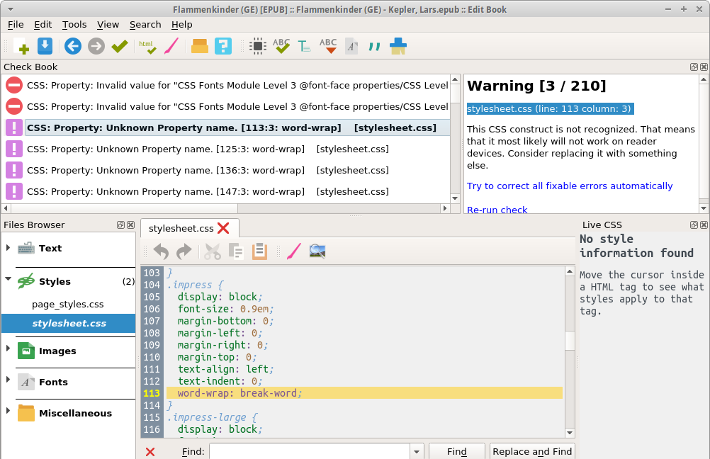

A book got multiple warnings which are all not to correct automatically (via ''Try to correct all fixable errors automatically'',
a dozen
Name:	CSS_Property_Unknown Property name. (113_3_word-wrap).png
WARNING: CSS_Property_Unknown Property name. (xxx_x_word-wrap) (stylesheet.css)
Description: This CSS construct is not recognized. That means that it most likely will not work on reader devices. Consider replacing it with something else.
With what to replace? Can't I delete all these lines showing word-wrap: break-word?

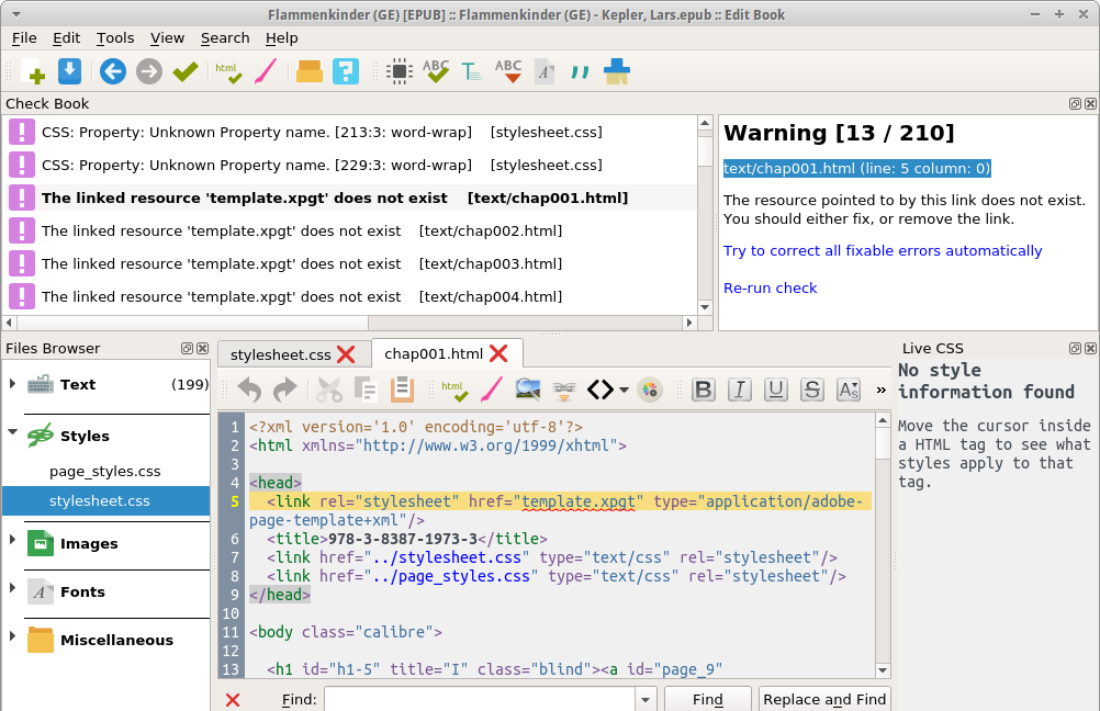

and about 200
Name:	The linked resource template.xpgt does not exist (text_chap001.html).png
WARNING: The linked resource template.xpgt does not exist (text_chapxxx.html)
Description: The resource pointed to by this link does not exist. You should either fix, or remove the link.
I don't know how to fix, but I may remove these links. Yep!
The general problem is the sheer mass of warnings. Exist a possibility to correct in bulk?

I generally just remove all the lines it's objecting to when I see warnings like this, and nothing bad happens.

Make use of Search and Replace to find all occurrences and change them.

double click the error or warning (left side), it will take you there
NOTE Both of those are simply warnings (advice)
The first make viewers like used in Calibre and Sigil behave nicer
The second is just (possibly) wasted space (and annoys some distribution suppliers Validation)
If you double click this warning, it will show the File. The file name in the Files Browser will be italic
Your choice with warnings

Think about the work time! There are 208 of them. Probably you meant the removal with Search and Replace.
Works fine! To mention is the right selection where to search
Name:	All style files.png
All style files respectively All text files for the second group of warnings.
