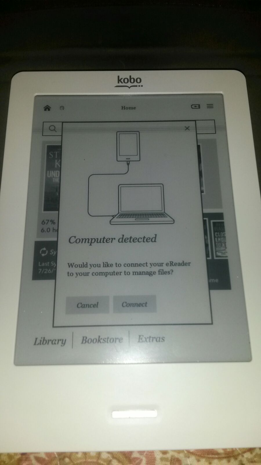

@robko: attached, please find a photo of the screen. No matter what I do, it is all that is displayed.

That suggest the screen is broken. There are some lines across the top of the connect dialog that don't look normal. They could be ghosting artifacts, but I think it is more likely caused by damage to the screen.
As you have done a factory reset, force a power off and plug it into a PC. From memory, when you do this with a Touch, the device will start and automatically mount so that the Kobo desktop can access it. If you can see it on the PC at this point, it means the screen is broken. You can do this after the device has started, but that means knowing where to tap on a broken screen.

This, and use a different cable/USB port if possible to rule out a charging issue. Screen doesn't look like it has a broken substrate but as David pointed out the "line" across it near the top doesn't look normal either so could be a screen controller issue. But if you aren't getting a charge that will prevent the screen from being changed or a factory reset from working.

If the LED flash and screen is still the same like the picture you post, it may suggest the screen failure/broken.

I connected the device to the PC, and the power LED blinked green, then blue, then green, then blue and then a couple of green flashes. The PC still does not recognize the device, and the display on the device also does not change.
You have to first select the "connect button", only then can the PC recognize the device. If your screen is broken, you can try to poke the "connect" button without seeing it. With FW 3.18.0, the button is in the vertical middle of the screen, around 25 mm from the bottom border.
