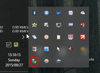

A quick way to check whether or not Windows sees it as a removable disk might be to look in "Safely Remove Hardware..." gadget list in the tray
Name:	Screenshot - 2015_09_27 , 13_10_22.jpg
Are you using a USB Port external on a hub, monitor or keyboard or something. They've caused me grief in the past.
