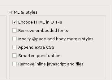

It sounds like the book has a faulty character encoding.
If you have Calibre, there is a very useful plugin called "Modify ePub" which has an option to "Encode HTML in UTF-8".
I would try deleting the old book from the device, use the above option in Calibre, and reload the book to the device to see if that fixes it.
Last edited by GeoffR; 09-22-2015 at 09:45 PM. Reason: added Modify ePub screenshot
