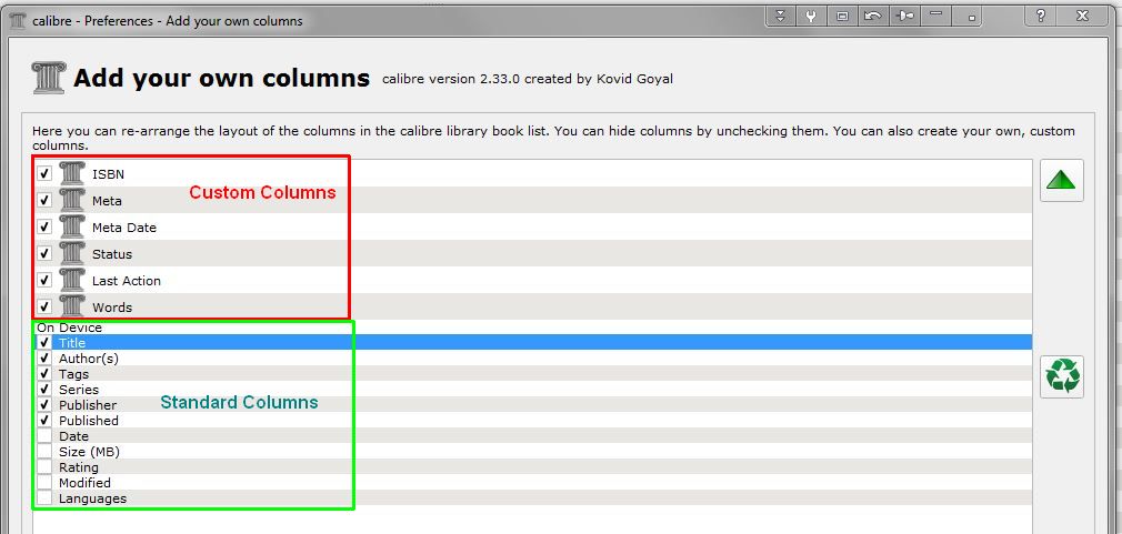

Old 07-30-2015, 08:40 PM   #15
Posts: 22,055
Karma: 30277960
@tamhas - for future reference, it's easy to see which columns are 'standard' and 'custom' - the presence of an ionic capital icon indicates it's custom.
