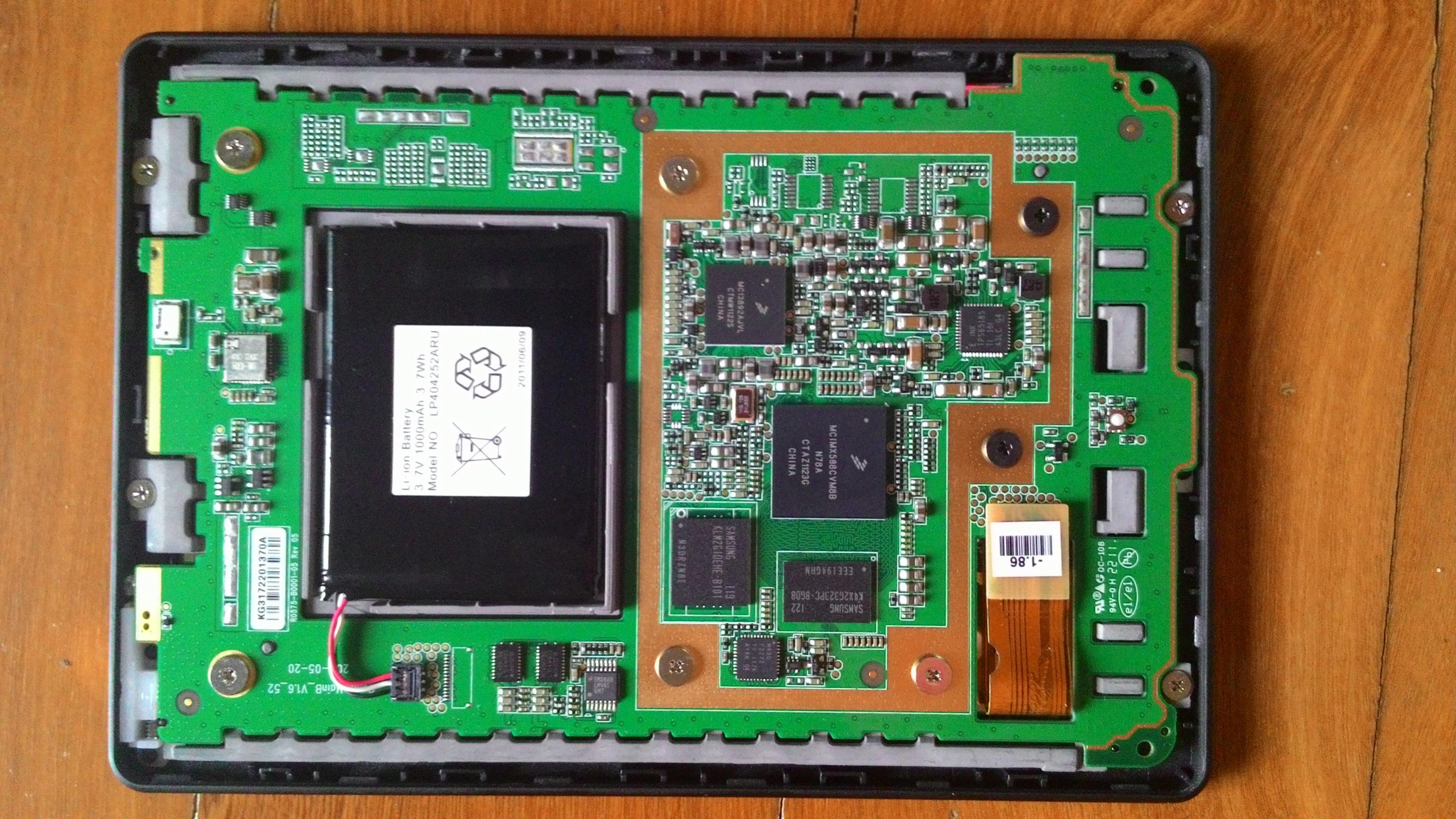

Hello, anyone can guide me where is Kobo Touch's internal SD card?
I've removed Kobo's back cover, and I really have no idea how to remove the SD card inside
Also, some websites figure out that some hacks let users install Android without removing internal SD card, but I can't see there is any method, as the instructions on this page said that it's a must to remove internal SD.
Thanks in advance!

From what I can see, your model has the soldered memory, so you can not remove it.

Yes, that looks like the original N905 version. These have fixed internal memory.

Try to understand that the original Touch has NO internal SD card and had been said many times while yes you can backup the internal flash based storage too your heart as content there is NO way to restore it.

Most of the people I've seen trying to restore a device have had to do so when it wouldn't boot. Without the internal uSD card, it's going to be hard to restore a device that doesn't boot.

No, I don't expect insurance. What I do expect is to ensure that someone is aware of the risks they are taking beforehand. In this case, the risk being that since neither the Touch N905 or the Aura have a removeable, externally writable uSD card for internal storage, you take the risk of having a rather expensive paperweight if anything goes wrong. IMHO, this makes them a poor choice for installing Android.

Mh, excuse me, I missed out the point that he has a N905 Touch. No, no one uploaded a working image for that model. On the contrary, I know that an user reported that he bricked his N905 trying to flash the andorid for Touch image. So no, the only way he can use it is to buy another Kobo with an internal SD card or see if it can restore the image using a jtag cable.
