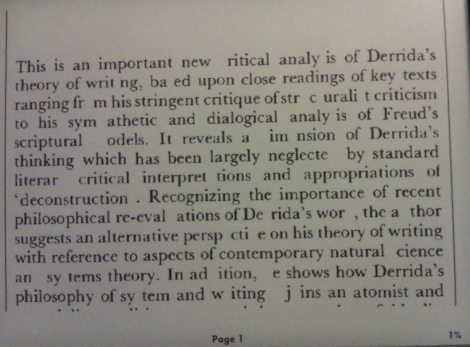

I have a Kindle Paperwhite and a big collection of scanned pdfs. My experience is bad most in most of the cases and I would never recommend the Paperwhite to someone that wants to use scanned pdf files.
What is really *annoying* is that I did not have this problem in my kindle keyboard and I have recently seen that the Kindle 4 deals ok with scanned pdfs as well.
When I contacted Amazon, their answer was vague and not very helpful, kind of someone tells you that they take note and will report your problem to someone that, at the same time, will have to pass it to another guy... so forget about it. Last updates of the firmware did not solve the problem and I lost all my faith in them months ago...
Any reflowing app is not even a suggestion here, unless the pdf has been thoroughly reviewed trhough a good OCR software, which is usually not the case.
Another problem that I have found recently is scanned pdfs with missing letters when they are opened in the Paperwhite (see attached file below).
My hypothesis is that the increased resolution in the Paperwhite makes it harder for the processor/memory to render and display scanned pdfs properly. That would explain as well the problems with the "low memory" message that
is unfortunately frequent to many users that want to read pdf files in the Paperwhite.
My suggestion: get a Kindle 4 or an iPad.
Contrary to the opinion to many people the Kindle —or any other ereader— could be more than decent displaying pdf files. The lack of commitment of Amazon and other companies for this format is a shameful consequence of incompetence and a narrow commercial strategy focused on selling ebooks rather than making decent machines.
E-readers are cheap toys created mostly with the intention of selling bestsellers... junk-novels or popular science books that people read in the public transport and that can be easily forgotten when finished... not for serious readers that want to work with annotations in a more advanced level, or that want to organise their libraries with multiple folders or tags, or use pdfs or other formats, or browse quick and seamlesly from one section to other inside a book, or enjoying a minimum level of usability etc.
That's why in my opinion Amazon will fall far behind Apple when the iPad mini with retina display reaches the shops. OK that the e-ink display is nicer for reading... but the disadvantages of the Kindle are many and quite annoying.

Just an observation: K4 and prior used Adobe RMSDK to render PDF. Kindle Touch and Paperwhite do not (maybe it is some PDF library from FoxIt which Amazon has a stake in). So there are going to be a lot of differences. For my PDF requirements, Touch and Paperwhite have much better PDF support (for example, PDF bookmark and hyperlink support).
Scanned PDFs are a headache, chew up a lot of storage, and are not accessible (no text search etc) so I would OCR them at the least if I wanted to put them on my Kindle.
Also I find that increasing the contrast a notch can make text more readable most of the time. That's an option for K3 and later I believe.

@Zistmo I agree that Eink and scanned pdf equals philosophic reading .
As a Kobo Aura HD user I am starting to be quite happy with reading scanned pdf's in koreader.
There are some shortcomings (dictionary and notes are not really working perfectly.) And seeing your picture in #7 I do wonder whether setting the text to "darkest" or high quality with reflow will give a good result. Question is whether you should blame the reader (device/koreader)?
Blame the scan. I do. I use Scantailor to make the texts really black&white again. (I can't find the beta-version I am using anymore online, so I put it here.) (This answers the question in post #1: Can I smooth the fonts on the desktop, too.)
I use it before I OCR with Finereader, forcing it to leave my pages unaltered. Version 11 allows you to save to epub directly. Although a non-linear type page with greek and schemes gets hopelessly jumbled. So I mainly save to pdf files with exact image with text underneath. Adding bookmarks in Acrobat results in a competitor for the real book! Only real problem for the digital copy is that I can't write in the margins.
