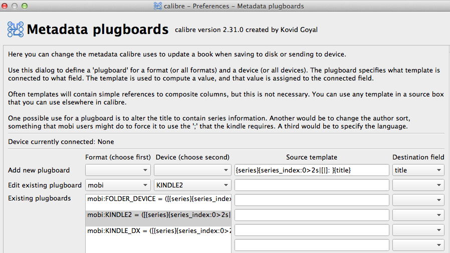

I just bought Kindle Paperwhite 2015. Apparenly I can't jailbreak it (easily), so I can't connect it directly from Calibre. So I intend to upload using "Send to Kindle" app, which is extremely primitive, but works.
but I have many many books that are in a series. And having found out that Calibre Series metadata doesn't really translate to Kindle Collections, I am opting to renaming the title using the Metadat Plugboard before uploading to my kindle account (either manually e-mail, or save the converted file in a folder, and then upload using "Send to Kindle" app)
Here's the situation:
a. I can translate from .epub to .mobi using "send e-mail to ***@kindle.com" and successfully upload the .mobi file to my Kindle account
b. I know how to manually translate from .epub to .mobi without e-mailing out. but I don't know how to direct Calibre to output the converted files to a specific file location..
the problem:
1. I can't get "send to device" with the Metadata Plugboard template, to covert the title using the source script (just keeps the titles same)
2. since I can't find "KindlePaperwhite" as an available device on the Plugboard, I chose Kindle2 for my kindle device in the setup wizard, and chose Kindle2 as the output device in the Plugboard, hoping that will trigger the title conversion.
3. even if I have .mobi-->Kindle2 setting with the following source template, although I can get the file sent to my kindle, it won't change the title:
{series}{series_index:0>2s|[|]: }{title}
so since I can't get the above to work,
1. I was wondering what am I doing wrong
2. if it is possible to make Calibre export the file to a specific folder on a computer first.. so I can validate the change in the title before I upload it to my Kindle account manually (e-mail takes too long)
3. is there a way to get kindle paperwhite 2015 for the Metadata Plugboard device option? or which devices should I be using? or what to choose for folder output?
any help is greatly appreciated. I'm so frustrated (loved Marvin on my iOS, but now Calibre won't talk to it either.. grrr)

Sure, use metadata plugboards and set the device to save_to_disk, then use the save to disk button in calibre to save your books to the disk.
Or alternately use connect to folder in calibre and set the device in the plugboards to FOLDER_DEVICE

thanks so much for helping! I think I got the save_to_disk to work to change the title, but I can't get it to translate from .epub to .mobi.
do I have to generate .mobi first and then translate? or is there some setting i can change that will translate to .mobi if I use save_to_disk?

Use connect to folder instead, you can customize it to auto-convert to a format if the that format is not present when sending books. Do that by right clicking the folder icon after connecting and choosing customize this device, then make sure mobi is the only allowed format for sending.
If you want to use save to disk, you have to convert first.

thanks so much! I got the connect to folder working! whoo hooo!!!
You're the best!

I also found out for Kindle to display and sort by a particular title, I have to output to {title_sort} using save to disk...
but I got it to work!
use FOLDER_DEVICE
format so that .mobi will convert using
{series} {series_index:0>2s|#|-}{title} --> {title_sort}
then export to the device.. then upload to Kindle! Yay!
