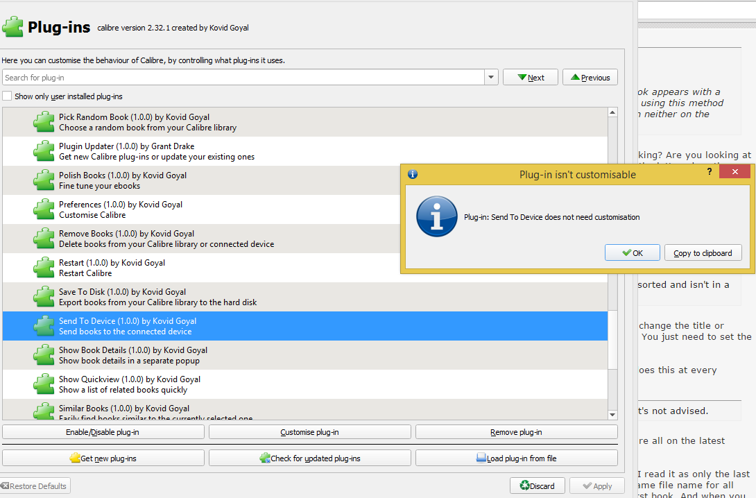

"You just need to set the metadata plugin for the "Save to disk". Does that relate to either on the screenshots or is it somewhere else? Not sure what setting to look at there.

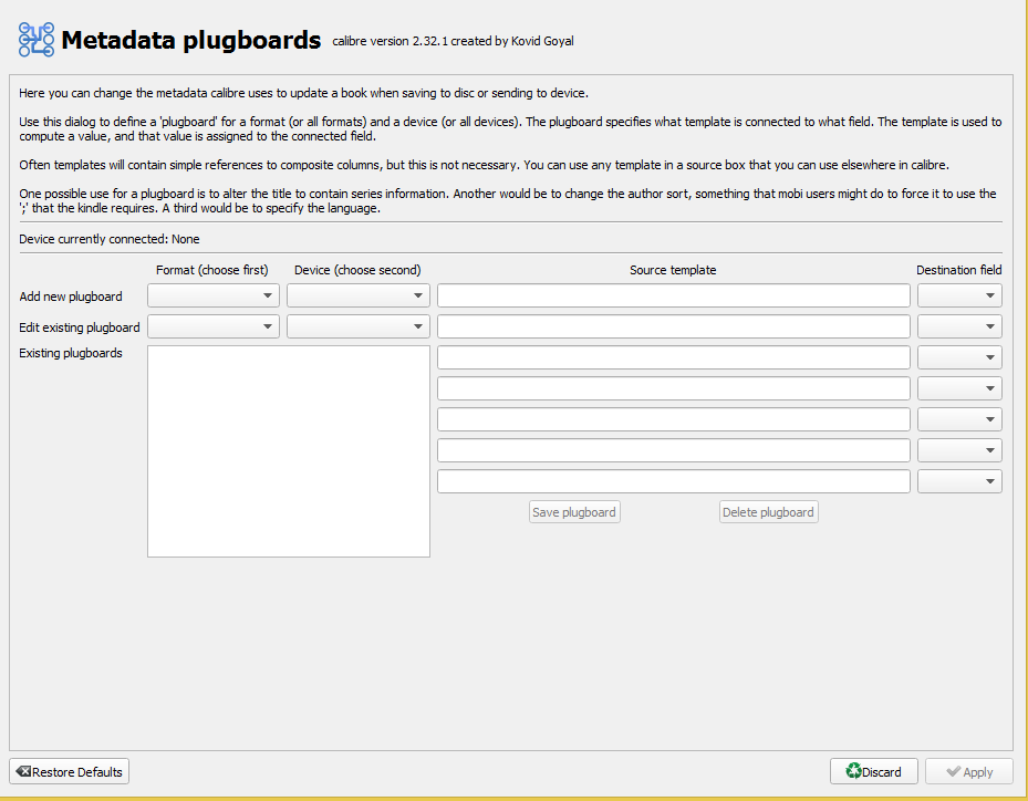

Calibre does update the metadata when you do a save to disk. But, if you are using a metadata plugboard to change title or something when sending the book, those changes won't be made.
No. And I just realised I said "metadata plugin" when I meant "metadata plugboard". This is in the middle line on the main preferences page. I have been assuming you have used this before to create a plugboard for the Kobo device. You can also create one for the "save_to_disk" device.

Link to the plug board page. Doesn't seem to be anything on there, can you link to the preferred settings at all please? The only thing like this I've done is added the shelves column and setting.

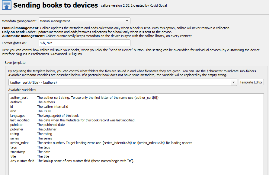

Ok, you haven't made any changes there. So, it is the device driver that is configured wrong. My last post had instructions for getting to this. I'm at work at the moment, so can't take a screenshot to show you my configuration. But, when you see the configuration take a copy of whatever is in the "Save template" field. The replace it with:
{author_sort}/{title} - {authors}
That is a good default. Save the change and restart calibre when prompted. After that, the send should work.
And please post what was in the field. I'm curious about what it was.

The {author_sort}/{title} - {authors} change worked..ish. Before that there was a #myshelves entry which was trying to save everything into a myshelves epub file on the main memory which seemed to be causing trouble.

Looking back, I suspect you had the driver configuration swapped. The values for the Save template and the collections columns were swapped. But, have a look at https://wiki.mobileread.com/wiki/Kobo...nd_Collections to get the configuration right. And if it is still not working, I need a debug log to look at.

All working so far. Followed the link and made the change by adding the #myshelves.
It was as you thought, the data was mixed up. How that happened or how it was set like that and still working I don't know!
