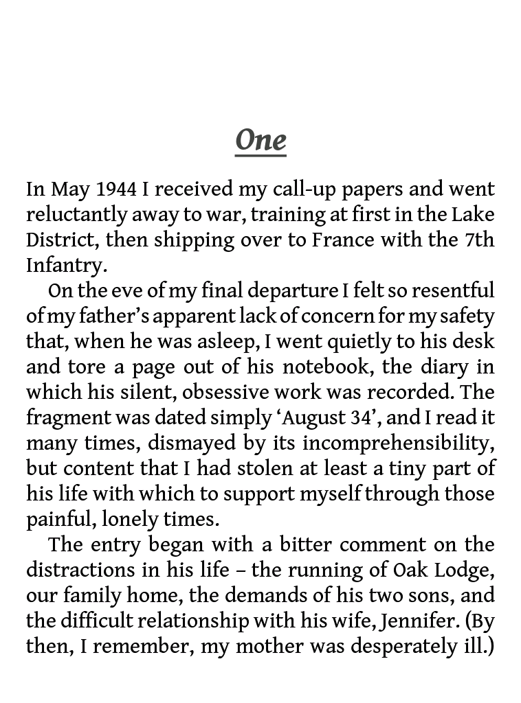

I took some sreenshots, difference can be seen better.
This is without hints: http://drop.muratcansimsek.com/wh.png
This is with hints: http://drop.muratcansimsek.com/h.png
I think one without hints are infinitely better than the other one.
The one without hints has the xheight of letter 'i' a pixel shorter than letter 'r' and 'v' in the word "drive".
That would drive me nuts, because my eye stumbles when it finds such irregularity. This is exactly what hinting is supposed to prevent.

It doesn't look like that on the screen, screenshot feature isn't working perfectly:
Sorry about the bad focus =)
This is the same type, but I took a better photo: http://drop.muratcansimsek.com/IMG_20150520_144417.png
