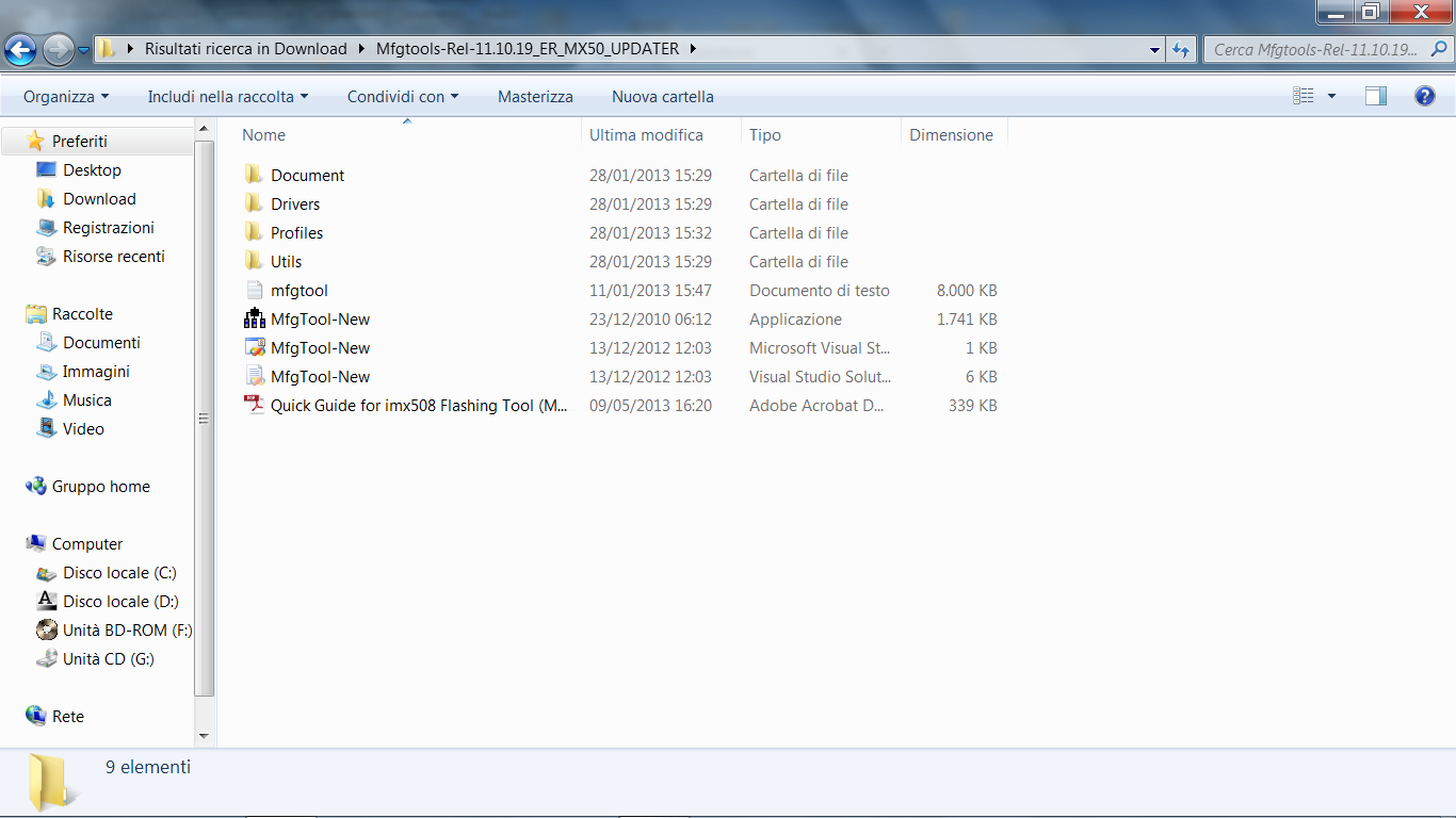

Originally Posted by Randy11 View Post
With the standard M92, there is also a passwords, but you only put the file on the filesystem without unzip it to upgrade/downgrade the firmware.
Hello, I downloaded the firmware 20131129. Where do I get the update? Which folder? Thanks!
