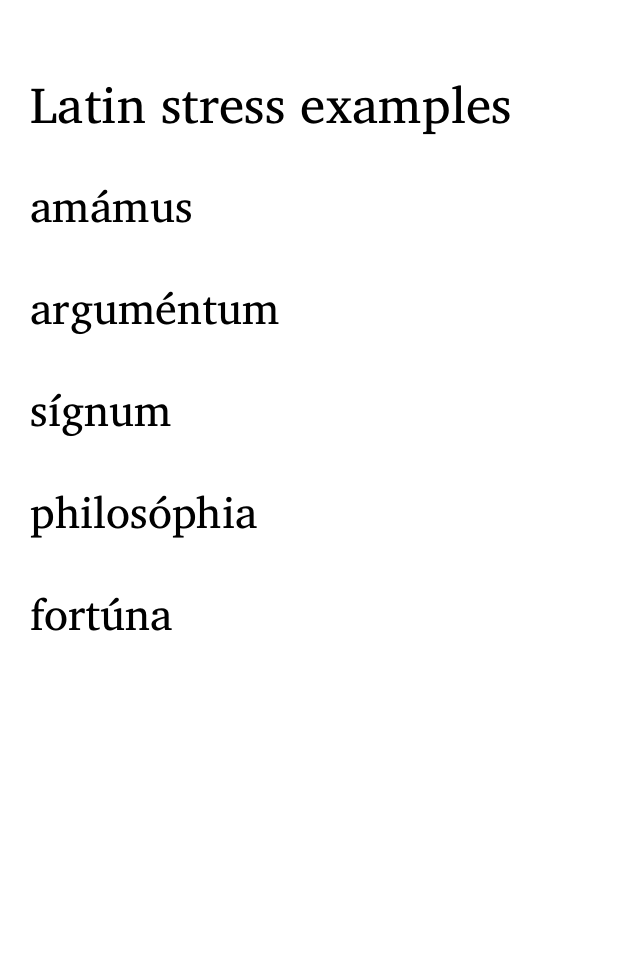

Originally Posted by Bilingual View Post
Another project, I'm trying to get ahead with is a latin text. Her, I'd like to have some stress-markers in the text, but have them basically invisible for the purpose of text searching.
IMHO, the easiest solution would be to mark the stressed syllable as bold. You could also automatically display it in upper case letters using text-transform: uppercase. However, very few readers support the text-transform property.
For example:
<?xml version="1.0" encoding="utf-8" standalone="no"?>
<!DOCTYPE html PUBLIC "-//W3C//DTD XHTML 1.1//EN"
  "http://www.w3.org/TR/xhtml11/DTD/xhtml11.dtd">
<html xmlns="http://www.w3.org/1999/xhtml">
<head>
  <title></title>
<style type="text/css">
.stressed {font-weight: bold; text-transform: uppercase;}
</style>
</head>
<body>
  <h3>Latin stress examples</h3>
  <p>for<span class="stressed">tu</span>na</p>
  <p>philo<span class="stressed">so</span>phia</p>
  <p>pe<span class="stressed">cu</span>nia</p>
</body>
</html>
If you're planning to write a couple of Latin textbooks it might make sense to create a custom font in which all regular Latin lowercase characters have an acute accent.
Since the Latin Extended-A and Latin Extended-B Unicode ranges already contain precomposed glyphs with acutes, all you'd have to do is overwrite the regular Latin glyphs with these characters.
This can be easily done with a freeware font editor, e.g. Type light.

Originally Posted by dgatwood View Post
Won't work. You have to have letters without accents in the same word, and if you try to wrap a single syllable or letter with a font change, you're likely to run headfirst into a nasty ADE bug.
The bug that you've linked to doesn't seem to affect the solution that I've suggested.
I've slapped together a proof-of-concept ePub with a Charis SIL based custom font that contains only the letters á, é, í, ó, ú and ý; it works fine with iBooks, ADE 1.7.2 - 4.0.3, ADE-based iOS apps and CoolReader.
