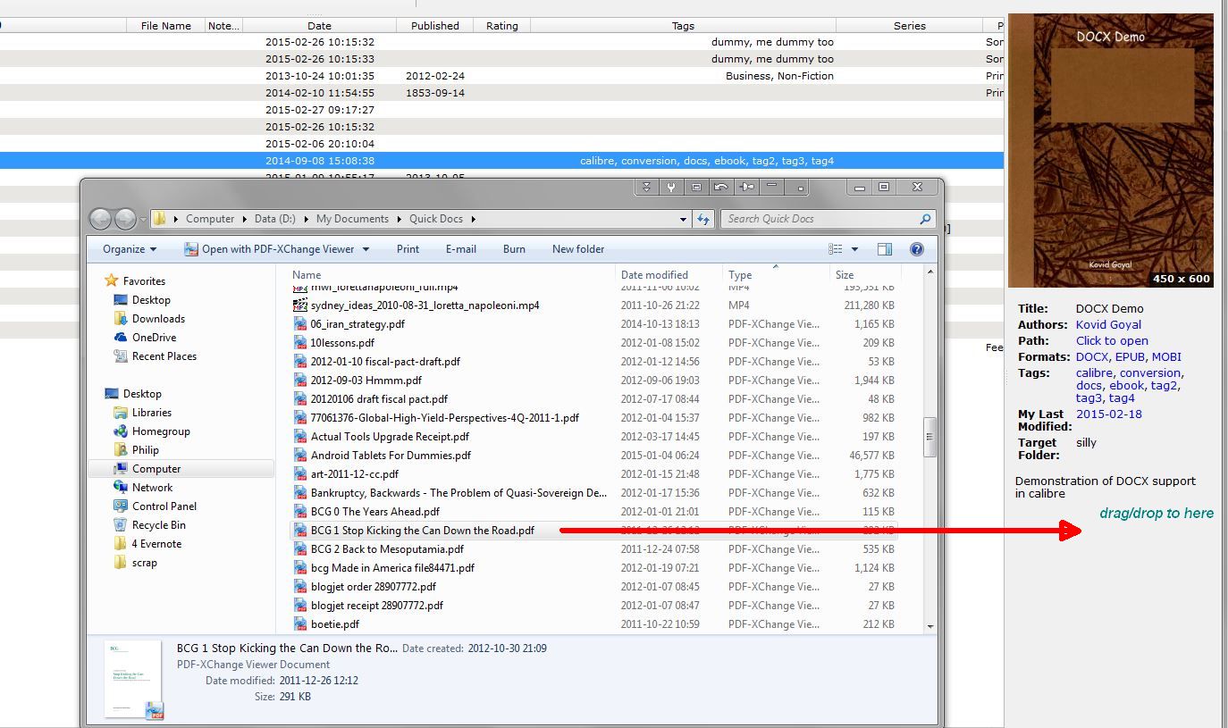

Old 03-24-2015, 04:57 PM   #6
Posts: 22,070
Karma: 30277960
Originally Posted by taratears View Post
I'm not sure what you mean here. The physical file on my drive? or do you mean something else?
@taratears - if its an ebook format (epub, mobi, pdf, docx, lit...) drag/drop the file from file manager to the book details side bar. This will not work with 'foreign' files such as mp4, flac, xlsx, etc.
Added : if the format is already in the book folder (but not 'registering' in the db) this will work fine - I do it at least a dozen times a day
Or use Add->Add files to existing record (shift/A). If you want to add 'foreign' files to an existing book, you need to use this option, and you must adjust the file type selector to 'All files' .
