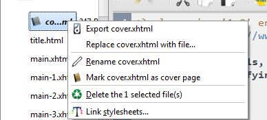

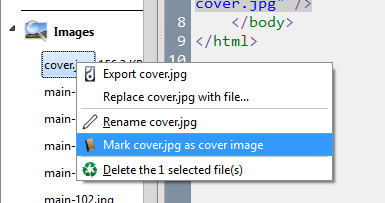

Why do I have the option to mark both an xhtml file as a 'cover image' and an image as a cover image? Why wouldn't there just be one 'cover image' option? This seems so silly and unintuitive.

This question seems silly and unintuitive.
Well, so are the EPUB "standards".
Both are needed and for obvious reasons should match.
Kindle formats will just use the marked image, EPUB looks for the coverpage (but I think not all readers).

Because a coverpage COULD be text with a smaller image (eg the old Calibre look)
So the page needs to be ID'd
then the image flagged, just in case an automater wants to replace just that piece

The problem is that there are two ways for an ePub reader to decide what to use as the cover image. One is to take the first page of the ePub and use that as the cover. The other is to look for a meta tag for the cover in the OPF and then use the graphic pointed to by the meta tag for the cover. This only effects thumbnails as in cover view.

There are perfectly valid reasons to want to have an image marked as the cover image (in the OPF metadata) WITHOUT having an html cover page (even one that contains the same image) marked as a cover page (in the OPF guide section) as a consequence.
Taking away someone's ability to do the one without the other (by automatically linking the two actions) would be presumptuous.
Quite simply put: cover page and cover image are not synonymous with each other. So 'marking' them should remain independent of each other.
