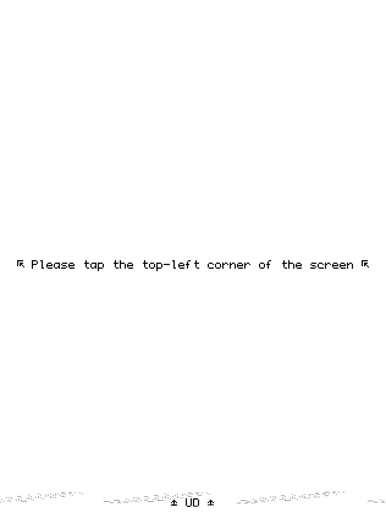

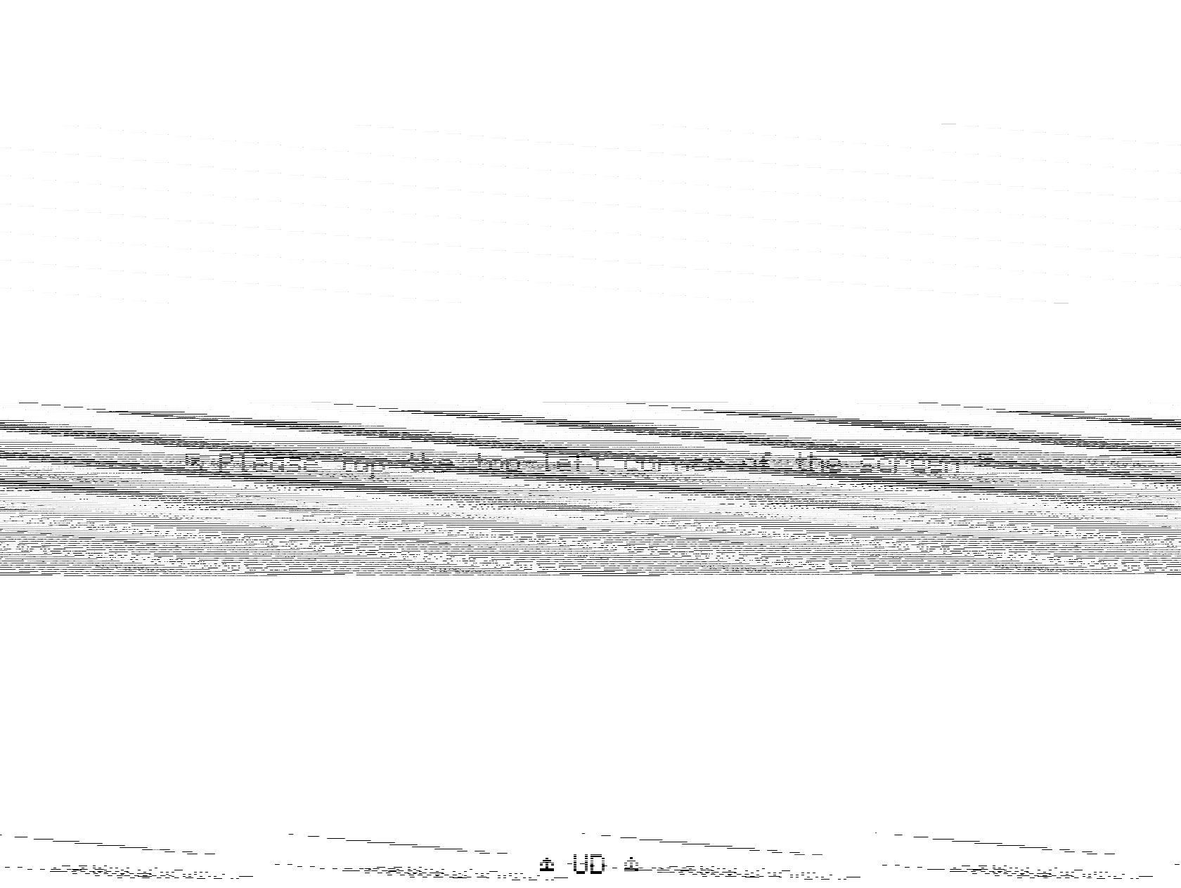

Can you try this one, and do *not* touch the screen at the end (wait for the 10s timeout)?
(I kinda forgot about this bit ;p).
The goal is to avoid any broken Nickel refresh for the final screenshot .

Done. Did not touch the screen.

Okay, that looks slightly less worse .
Does stuff magically work if you copy the fbdepth binary from that final package to the koreader folder (.adds/koreader, FYI), overwriting the older one in there?
(I suspect we're not quite there yet, though. I'll double-check the kernel tomorrow, once I have a working brain again ).
