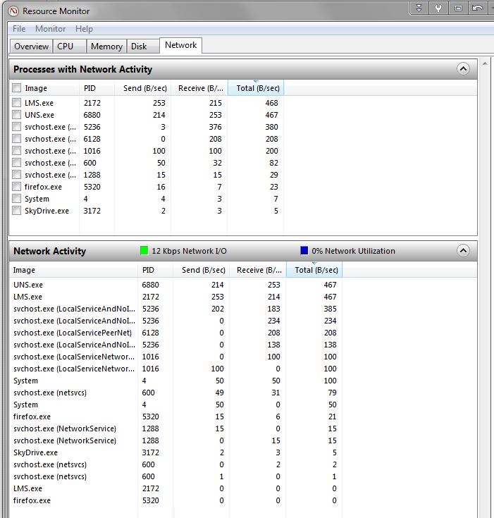

@ElWorm - Next time it happens go to Performance tab in Task Manager, click on Resource Manager button, click the Network Tab and have a look at the Network Activity panels - see attachment (BTW calibre was running when I captured that image, but its not doing anything network-wise, or anything elsewise).
To run calibre without optional PIs the see ==>> calibre command --ignore-plugins switch
