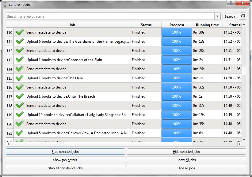

Kindle Voyage metadata transfer very slow
Just got a Kindle Voyage and I'm loading it with books from my Calibre library. I've noticed, looking at the jobs screen, that it seems to be taking a long time for the "Sending metadata to device" step: about 25s after uploading a single book; about 35s if it uploads 10 books. I'm sure it's been a lot faster than this on other devices - is this slowness due to something in the Voyage itself?
32-bit Calibre 2.8 running on 64-bit Windows 7.

Here's a screenshot which illustrates what I'm seeing. As you see, it typically takes around 2s to send a book from Calibre to the Voyage, following by around 30s to send the metadata. Is this what would be expected?

Sending metadata involves sending the metadata of all books on the device (the metadata is stored ina single json file), so regardless of how many books you send the time for sending metadata will be roughly constant. As for the increase in time, that will likely be because of the increased cover thumbnail size the Voyage needs.

Thank you for the explanation. That makes sense.
