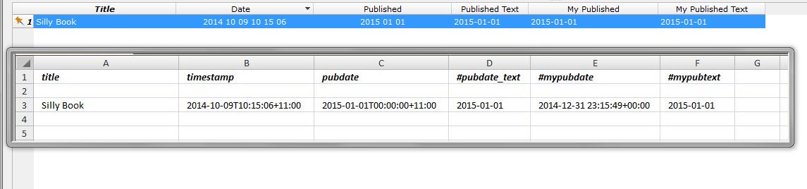

The attached screen shot overlays a csv catalogue on the calibre book list for a single book.
The Published and My Published columns are both formatted as 'yyyy MM dd', they were entered into the book list within a second of two of one another, both were entered as '2015 01 01' (without use of the calendar gadget).
So my questions are
  1. Why do they have different internal representations.
  2. And what does my local offset from UTC time have to do with the published date - currently +11, a week ago it was +10. Sydney's small beer when it comes to book publishing

The different 'formats' for 2015-01-01 are also in the metadata.opf, and they're what I see in metadata.db with SQLite Browser, so I have to question that the difference is an 'artefact of catalogue creation'.
It seems to me that the internal value for timestamp (Date) and pubdate (Published) are carried as entered, along with the locale offset from UTC. However, values for dates that I define are normalised to UTC time by applying the offset. Surely all dates should be subject to the same rules.
And it does matter, in order to get something sensible into a spreadsheet I need to have a template derived custom column the converts the date to a string. To do anything with dates in a spreadsheet requires a string 'format' that the spreadsheet software can cope with - eg to calculate the elapsed period between the publication of book A and book B.
Unravelling values like '2014-12-31T23:15:49+00:00' and 2012-07-23T00:00:00+10:00 in excel to get back to the values I entered - '2015 01 01' and 2012-07-23 - is vexing.

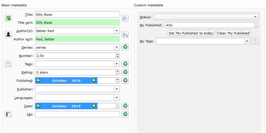

I tried defining all the dates as 'iso' to see if it would the overcome the inconsistency . But when I do that I can't even enter a full date; month and year is all I can get, see attachment. And the peculiar value in My Published, that was what I got when I clicked Set "My Published' to today - I'm guessing this is a cutie five glitch.
