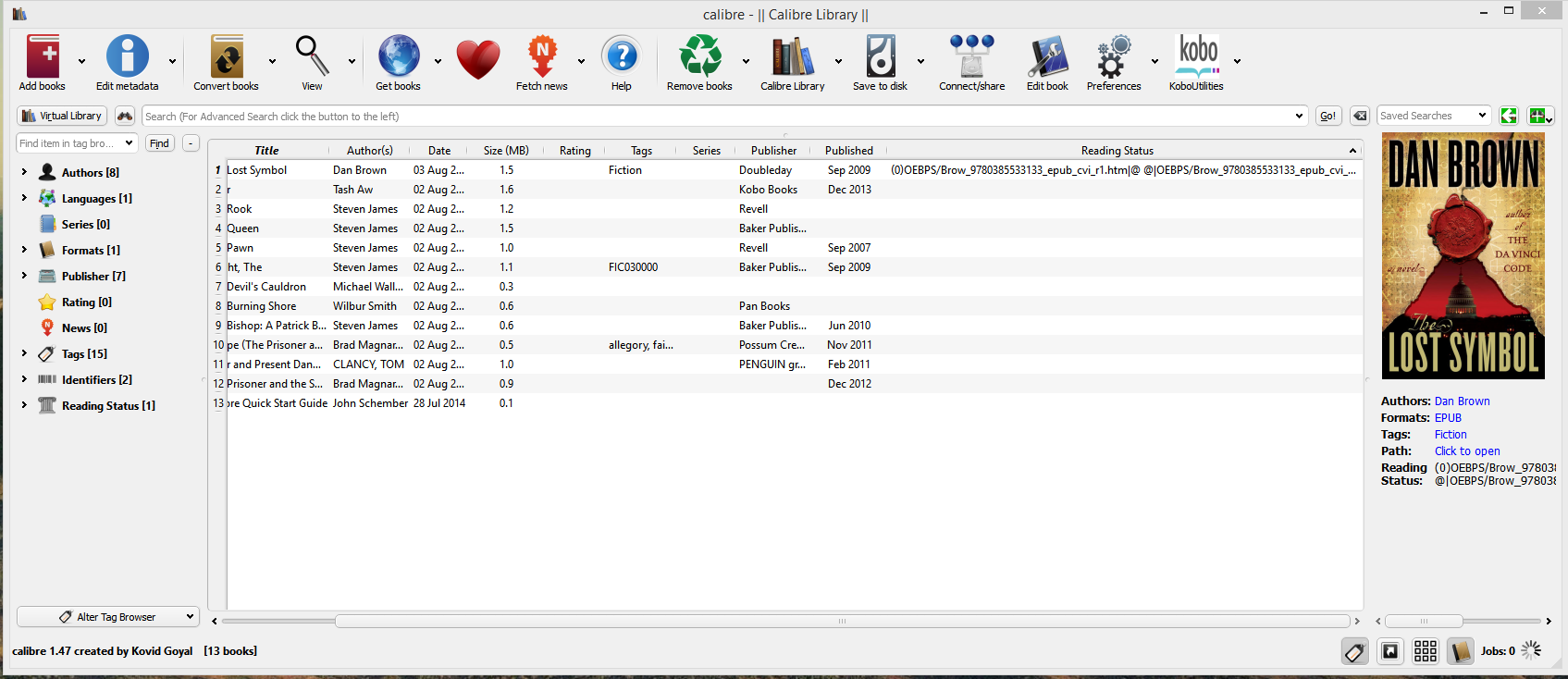

So it is working but what is contained in reading status is obviously wrong. I am uploading a screenshot.

That is working perfectly. As we've said in other posts, this data is Kobo specific. The only reason for storing it frankly is to allow easy recovery id you do a reset.

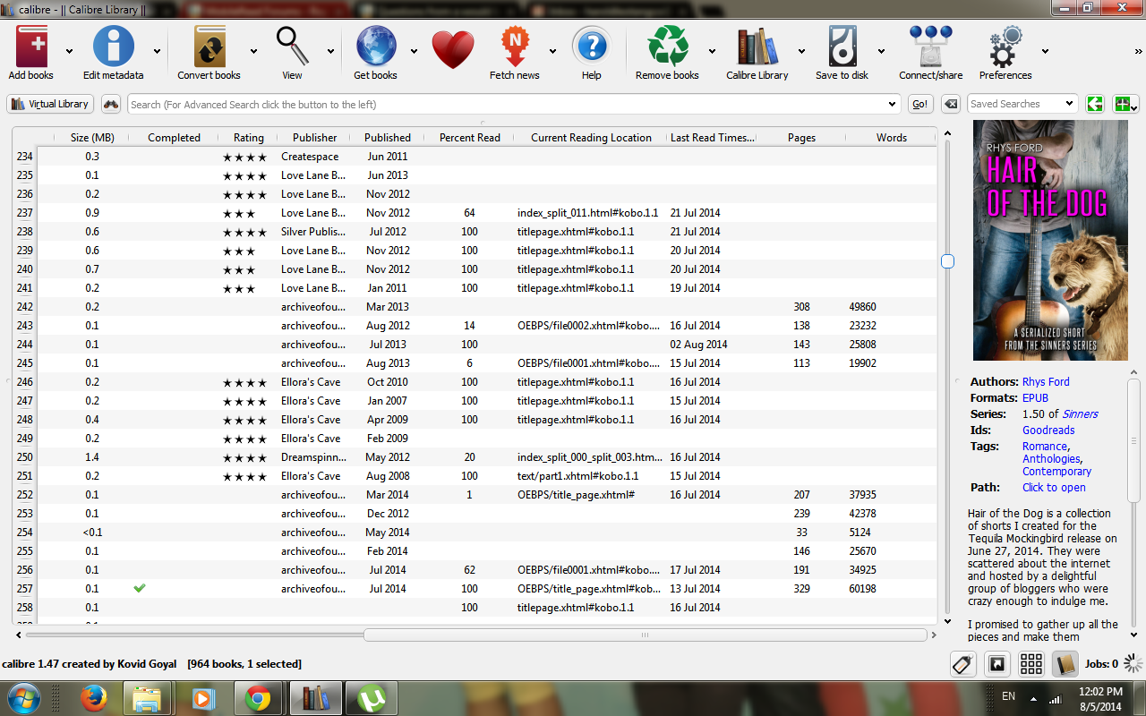

How many columns did you make, by the way?
Mine looks likes this:

The value you have stored in "Reading Status" column is the reading position as retrieved from the database on the device. And as PeterT said, it is mainly useful if you want to restore that position to the Kobo device. But, it can be sent to another Kobo device if it has the book.
Personally, I find the "Percent Read" and "Last Read Column" most useful. The former tells me how far through the book I am. When I reach 100%, I know the book is finished. The "Last Read Column" is the date when I was last reading the book. I like seeing that plus it is used buy the plugin when retrieving the positions to not retrieve an older position.
