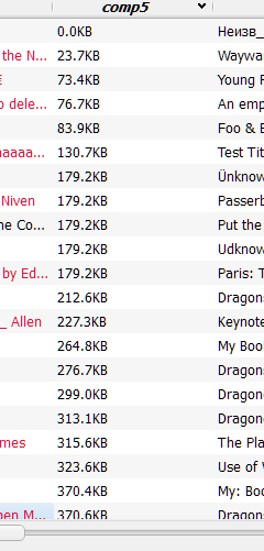

While this does seem to work for calculating the size, the sorting is not working. It still sorts as if the column is text.
Works file for me. The column sorts by number. See the attachment.
Also, is it possible to use the dot as a thousand delimiter
Don't know. I doubt it. I never have been able to make the 'n' formatting character (the locale-sensitive integer format) do anything useful.
and remove the decimal?
Make the template .0f instead of .1f.
