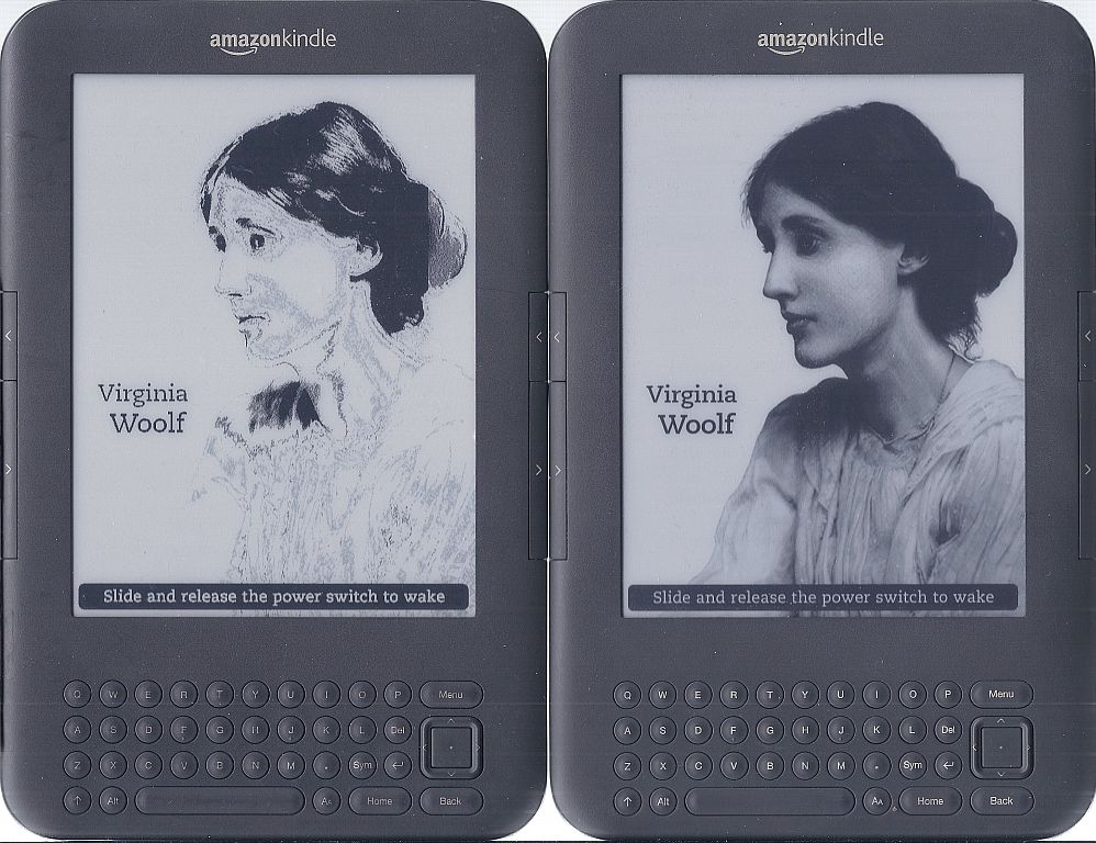

For no apparent reason, my K3 froze while reading.
I tried rebooting by holding the switch 30 secs etc, but with no avail. I connected to my pc, but did not show up. I charged it for about three hours (although the battery was more than 50%, and when I returned it had unfrozen. The problem now is that the screen saver picture is not complete, and looks like the picture attached.
When swithing back to the screen saver, the picture looks good for a fraction of a seccond, but quickly goes back to the picture as shown.
While reading the print also seems broken. (like missing pixels)
I opened up my kinde and found that a small screw had come loose and was roling around inside.

I've got a similar problem to yours which appeared after I replaced a broken screen on my Kindle 3 Keyboard.
I'm thinking I must have done something when I opened the Kindle that was similar to what your loose screw did to yours.
Anyway, I only had a few books which were affected by what you have nicely described as the "broken print" and I've managed to find a way around it.
This won't help with the screen savers or images within books that don't work properly, but it can make the print better in books.

You've managed to corrupt the screen waveform data. Sounds as if the loose screw has shorted something out. Not fixable, I'm afraid, other than by replacing the screen, and for information about that, see this thread.
