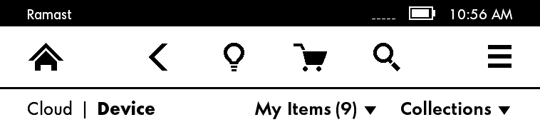

After 5 days of not using my kindle - except for checking its battery everyday - here is a screenshot of how much battery has been used.
please note that during the test my wireless was on and aireplane mode was NOT activated at any point.
If it is to continue on this rate I would estimate at most 15% battery decline in two month provided the kindle is never used of course.
