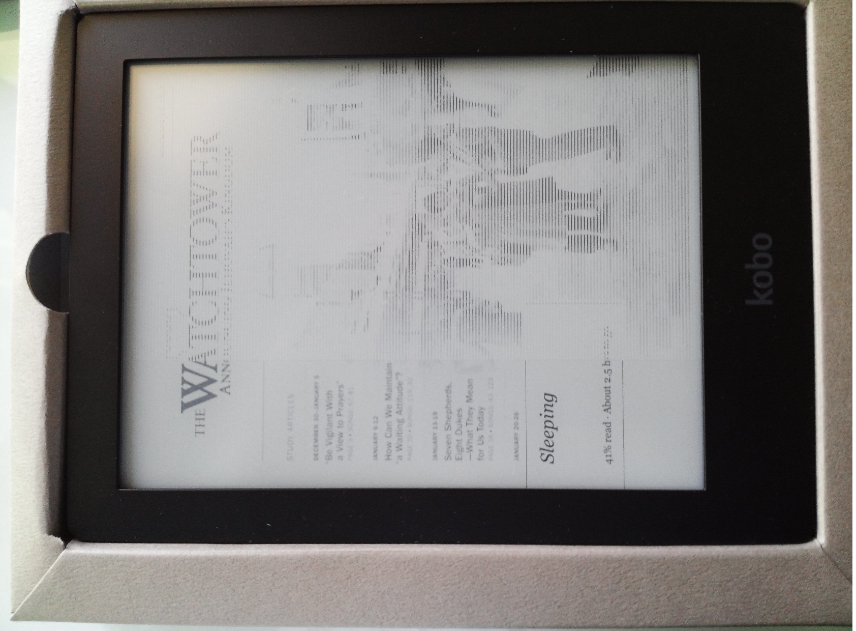

aura suddenly frozen without a cause in sleep screen
aura hd suddenly frozen after detached from case. i didn't anything to aura.
is there anyone who had experienced this? it's so astonishing thing.
i think sd card or firmware's collision is cause, i had disassembled it and exchanged sdcard and restore firmware backup'd. but still problem is.
then i asked to kobo exchange with email. because i live in south korea, they said i must contact with retailer or store. but i've preordered in official kobo site then i said 'i have no where to contact except kobo'.
how can i solve this problem? plz give me appropriate suggestion.
this experience makes me so disappoint to eink device.
please help me.

It is possible that the screen has broken, rather than it being a firmware or other problem. If it broke while the sleep screen was showing then it will continue to show that screen even if the rest of the device is functioning normally.
To test this, check if the LED flashes its normal sequence when you turn it on. Then try connecting it to a computer via USB (you will need to tap the screen where the connect button normally shows, even though you can't see it.) If it connects so that you can see the device's filesystem from the computer, then it is probably a broken screen.

Can you post a photograph of the screen?

ok. i tried to connect computer but led turn on and soon turn off not responsive. sleep screen is not broken at first while frozen, but screen broken after install backup'd firmware in internal sdcard and push reset button.
kobo replied 'Service can get through relative in the USA'..;;
I have not anyone.. damn!!!
what am i have to do? is there anyone help me?

I'm not 100% sure whether that screen is smashed or not, from the photo. I can't quite see the giveaway diagonal lines that are usually present with a fracture. But the fact that it happened getting it out of a case (was this a snap-in case?) is suggestive. Twisting or bending forces can break it quite easily, because it's thin glass.
When you took it apart, did you disassemble it enough to check out the back of the glass substrate, to check for cracks?

thanks. but i've opened it after frozen. just i tried to repair. case is sleep case in ebay(from china-plastic surrounded). substrate is normal. I couldn't find wrong in outward. if kobo cannot give repair or exchange, i'll wipe out kobo in my brain. I didn't give forces and collision for device at all. i've always used my device carefully. in addition, according to geoffr if just panel only bricked, i can explorer file system with connect to PC but it didn't response.

Well if you feel the screen is fine, Then perhaps you should do a factory reset. If the screen goes black and says restoring your device should be fine. It is hard to say if the screen is physically damaged it looks more like a dead battery that died mid change during the screen going to sleep or waking up.

Factory reset? I tried all things. Power+light button press long & power+reset pinhole, power+pinhole. Power led turn on normally and turn off soon, screen not change.
Forgive my poor english. But I hope you understand my astonishing situation.
As a result make conclusion with your saying... kobo good bye.
Hey fel? Is there someone buy my bricked kobo?

Looking at your image of the screen, it almost looks as if the screen is stuck halfway through a refresh.
Your list of what you tried did not seem to include holding the light button which is part of the Glo/Aura/Aura HD factory reset procedure.
Try the following:
Press and hold the light button.
Use a paperclip to trigger the pinhole reset.
Continue to hold the light switch for a minute and see if the LED starts rapidly flashing.
If this happens and the screen doesn't change, the screen is toast. It doesn't take much to damage the screen. Given that you opened the Aura HD, I suspect that any warranty you might have had has been voided.
Regards,
David
Try the following:
Regards,
David
I tried to this too. Just I gived up and mailed to kobo care. If they say voided warranty, i'll sell aura hd for spare.

It's hard to be sure from the picture, but if all the lines are straight vertical that might be a bad controller rather than a cracked screen. Rare, put there have been pics of that posted before. Bad controller should be warranty (aside from voiding by removing the back issue).
