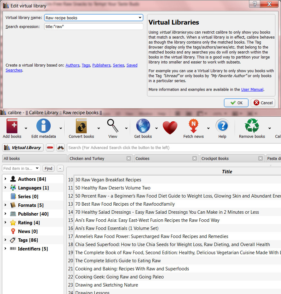

Here is a link to a screenshot of my query and results. Sorry for the low resolution. Items 23 and 24 in the list show examples of unwanted items.

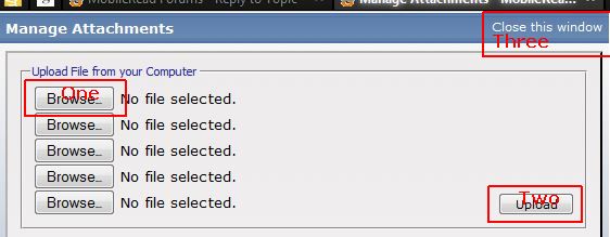

To add an attachment here, Click Manage Attachments (its below the compose message window) then see picture
One. Browse to your attachment(s)
Two. Click Upload and wait until it displays the filenames
Three. Click Close Window

Thanks! I wasn't trying to add an attachment, but rather insert the picture directly into my post. I've included it as an attachement.
The search query title:"=raw" wants books where the title is nothing other than the word raw, rather than a title with the word raw in it. I get a message that no results are found, because I dont own a book titled "raw". I have raw veggies, raw fruit dishes, etc. but not just raw.
There must be an advanced search query that returns the books that have the word raw in the title, but not the letters r a w in another word in the title.
I read the entire manual and it didn't solve my issue.
The pic. of my issue should be attached.

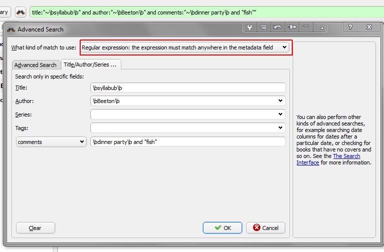

You might find it easier to use the Advanced Search (binoculars to left of search bar) - saves having to remember the column names, and you don't need to find the tilde key (~)
Basically you put \b (boundary marker) at the start and end of the whole word(s) you want match
You get to see the resultant search term in the search bar when you hit OK - its a good way to learn
The example in the attachment is of course silly, but maybe not if you changed it to
(title:"~\bsyllabub\b") or (author:"~\bBeeton\b") or (comments:"~\bdinner party\b and "fish"")
