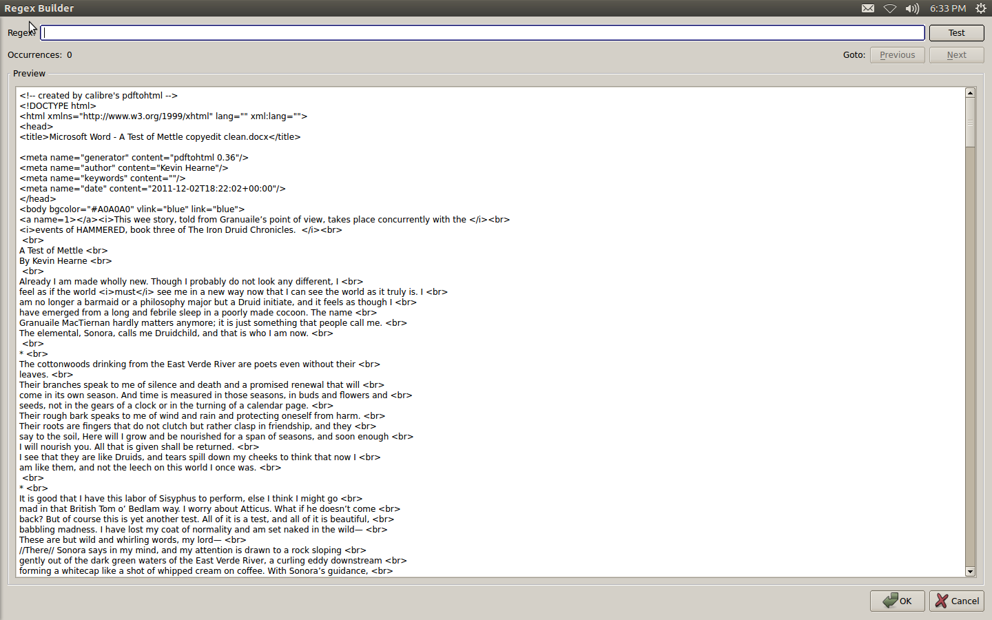

Originally Posted by Warren_Harding View Post
I clicked on the Wand button (with all the fields empty) and it fails to generate a preview.
Do you mean it didn't do anything, or it opened up a blank window?
It should open up a window titled Regex Builder. Looks something like the attached screenshot. If the Preview window is blank, maybe calibre doesn't see anything? Although seriously, it should at least show html and body tags.
If it doesn't open this window, maybe you need to wait longer for calibre to parse the entire PDF. The one I've shown is a 91 KB, 10-page short story offered for free from the author's website and opened pretty fast, but for a full-blown novel over 200x that size, it might take far longer to load.
It says that it fails to generate a preview, then the Regex Builder window shows up, but its empty. Yes, the book is ~935 pages, but since I don't see a progress bar or anything I have no idea whether it's still loading something or not.
Well, I have no idea why it should show an error message.
Unless someone here knows of some reason why that should happen, you might want to post a bug report.
Meanwhile, I would just assume it is pictures and try BetterRed's Google Drive suggestion. I never thought of that to be honest, but they do actually perform decent OCR for free. Or if you happen to have any OCR software lying around you can try that...
Old 12-20-2013, 12:58 PM   #12
chaley
Posts: 12,529
Karma: 8075744
Location: Notts, England
It there is no text in the document then it will generate an empty preview. I don't have the code in front of me at the moment, but I wouldn't be surprised if a book with no text produces some error message.
BTW: some PDFs are a combination of images and underlying text. The image is the "main" document and the text is used when selecting. The text is often generated by OCR and equally often has a very weak relationship with the text shown in the image. I don't remember if in this situation, calibre will try to grab the underlying text.
