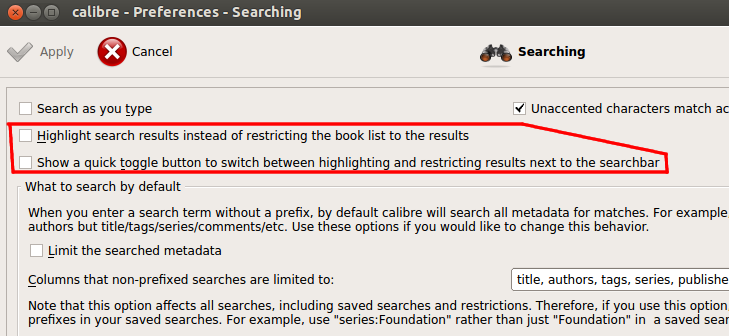

This was an update in calibre 1.11:
from http://calibre-ebook.com/whats-new:
Originally Posted by @calibre-ebook.com changelog
Remove the button to toggle search result highlighting from next to the search bar, as too many people click it accidentally and then do not realize what they have done, despite the confirmation message that pops up. The button can be restored via Preferences->Searching
See attachment.

True, if you are using a version older than 1.11, it will look like this: Click image for larger version

This is not a new feature. If you are not on a recent version of calibre then toggle the 3rd icon to the right of the search bar. If you are on a newer version then follow eschwartz's advice.
Thank you both -- I've got things where I want them again. No idea what tripped the toggle; maybe installing that "Find Duplicate Titles" plug-in.

It was more likely the change in 1.11, some other users had the same problem
If you always want to restrict the search result to matches - set the button to three blue bars and red slash, then flip the switch in search to off.
