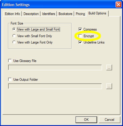

Alright, my Internet searching has come up empty, so I am bringing my newbie problem here. Sometimes when I create an .imp file in eBook Publisher, the program generates a key file (BookName.key) along with the .imp file. I can load the book onto my EB1150, but some books created this way will not open. I get an error message about needing to check the book back out, or something along those lines. Again, it's strange because some books work fine this way while others fail. I've tried both standard methods of uploading the book: impserve and direct copy (of both files) onto the Smartmedia card.
So, what am I doing wrong, and is there any way to get eBook Publisher to generate an .imp file without a .key file? Have I accidentally turned on some kind of library-book timestamp in eBook Publisher? Thanks all for any help.

Yes, there is a very simple solution to your problem. Do not encrypt the .imp.
When using eBook Publisher, go to the "Edition Settings..." under the "Build Options" tab and un-check "Encrypt". You must have inadvertently checked it.
The .key file holds the encryption information for Secure .imp, but it needs to be tied to your EBW1150's internal serial number for it to be read there. You cannot do that using the PC software as it doesn't know YOUR internal key.

Okay, thanks Nick, problem solved. The real mystery is how anyone could possibly hit that checkbox accidentally, but alas, I somehow found a way.
