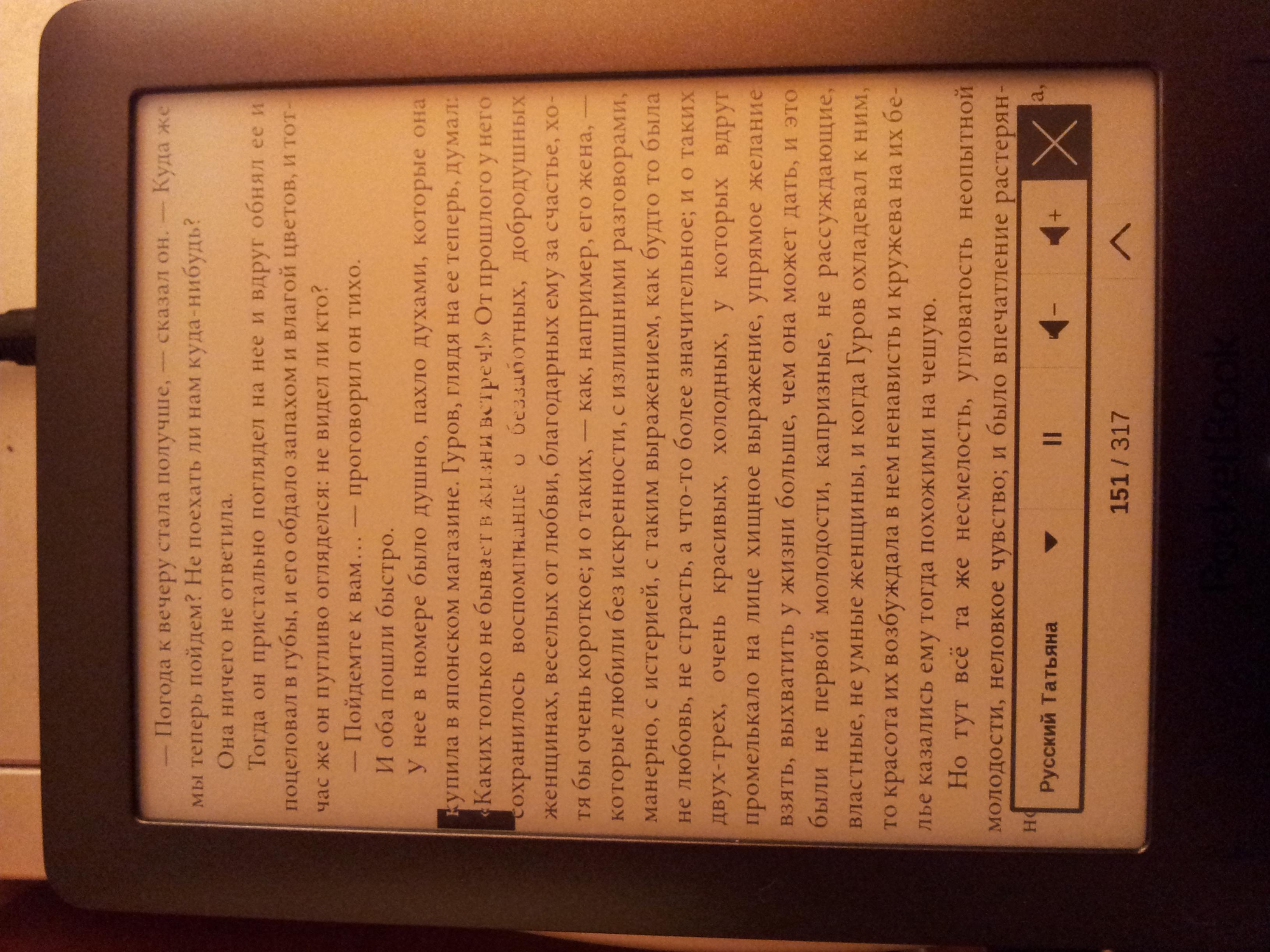

As an example of how badly the display degrades, have a look at the attached screenshot. This is what happened when I turned on the text to speech feature (which is pretty cool but also kind of buggy).
The black block on the left indicates the portion that is currently being read. Look at how badly the text on those lines displays. Have other people experienced this? From my perspective it's hard to consider this a market-ready product...

When I remember it right other owners have occasionally reported similar issues in the German subforum, for instance, after leaving the dictionary.
Maybe you can contact Forkosigan (a Pocketbook representative who is very active and helpful in the German subforum here, speaks Russian too) to ask him if you have a faulty device. Otherwise, do you still have a right to return the reader?
