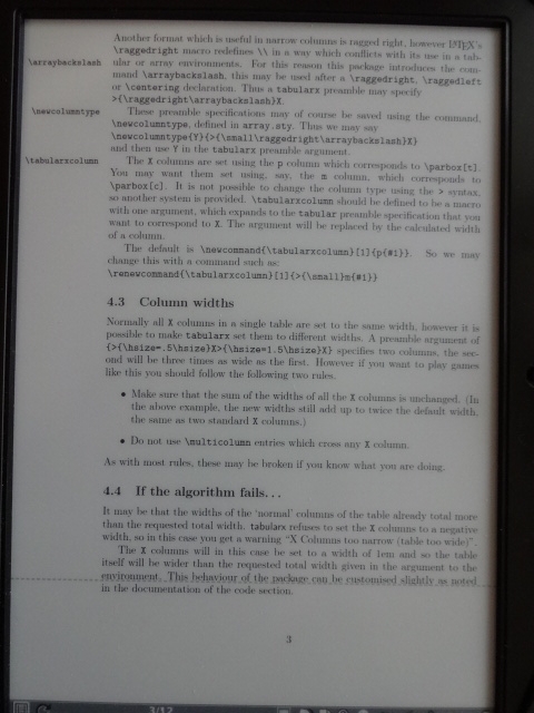

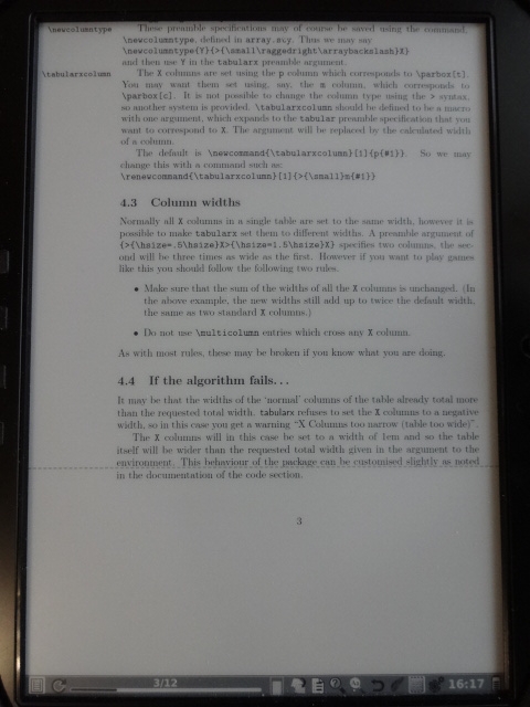

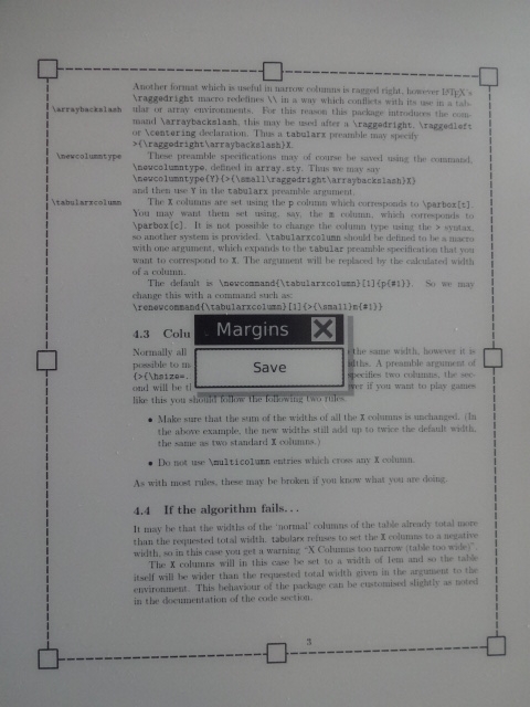

Bug 1.8 (1.8.20121113) + PDFReader_Patch 2013.01.02 : PAD/Key mapping => Page turn
Hi,
I've a bug with the PDF Reader (last patch) when I use the key mapping for the PAD. This is the actions to do to see my bug :
  1. Load the PDF file, I use "tabularx.pdf" but I've the same problem with other files
  2. Page Settings : Clear Margins
  3. Page Setting : Universal Manual => PICTURE 1
  4. => I get the PICTURE 2
  5. Tools : Key Mapping -> Page Turn
  6. Change page with the PAD => PICTURE 3
It takes 2 press on the PAD to see one page, then only one press of the button ">" is necessary and the page is fully displayed.
With the PAD, the first press show the full page and the second seems only to move the viewport.
This bug was confirmed by Vaa, thanks to her/him

Originally Posted by Randy11 View Post
Hi,
I am experiencing the same bug.
Earlier page turn was working fine even in two point zoom mode but now page turn moves the viewport instead.
