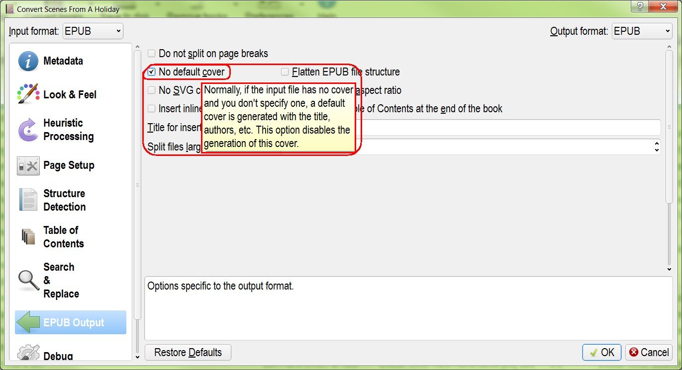

I don't think calibre does force you to choose a cover image. I haven't used it but during conversion go to the Epub output section and check the No default cover option and see what happens. See attached.
You know you'd think that'd work. But when I convert an .epub file with no cover image and click the box "No cover image" in the EPUB Output area, the program still creates a snapshot of the first page for the cover image and then adds that snapshot as the first page of the book. It pretty much has no change. And I'm using the latest version of Calibre 1.3
