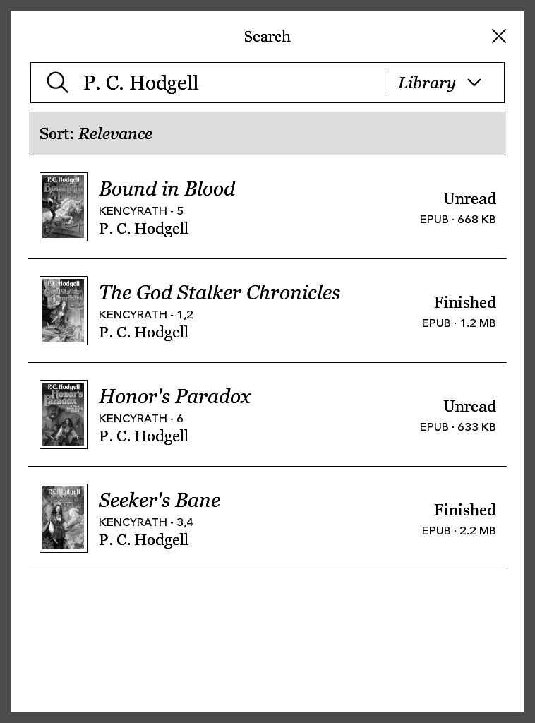

Edit: This is optional, most people will not want to bother, but ... Calibre has a limitation in that its series index can only be a number. It is possible to get around this by editing the device's database, setting the series information manually to anything you want, but in that case you would want to untick the KoboTouch driver's Set series information option to prevent it overwriting the manually set information. In the screenshot below I set the series index for the last book to 3,4 with the sqlite3 command:
UPDATE content SET Series='Kencyrath', SeriesNumber='3,4' WHERE BookID IS NULL AND IsDownloaded=='true' AND Title=="Seeker's Bane";

I tried Geoff's suggestion, and indeed, in my Red Mars bookshelf, the number of the series shows below the title, and above the author's name.
