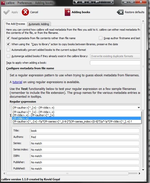

@woodapple If you can separate the author-title books and the title-author books into two 'piles' then you can select the appropriate regular expression from the Add Books Configuration and you won't have to do the adjustments
Enjoy your grad school sojourn

BetterRed and DoctorOhh, that is good to know that you can change what expression calibre uses to add the books. I just need to figure out a good way to separate my books into those two categories.
