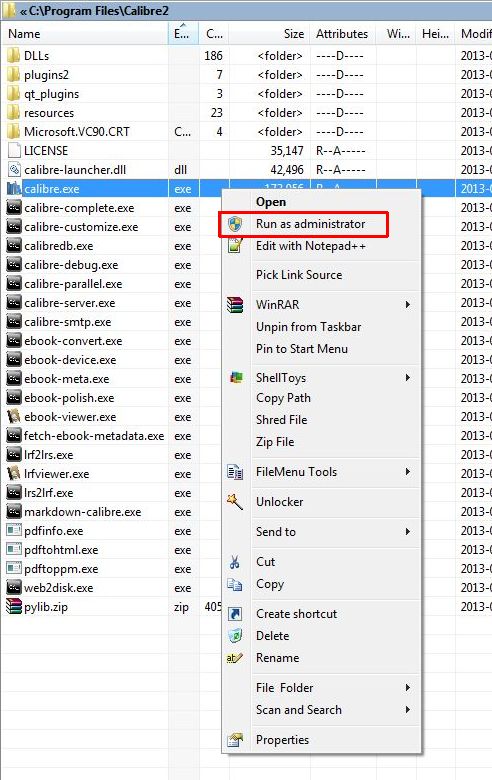

I assume the OP is referring to the Run as administrator I've highlighted in the attachment
Its an artefact of Windows Vista, Seven and Eight - and as far as I know its not needed for calibre, I have a recollection of KG posting that when it is used some calibre features wont work.
See Teach Your Apps To Play Nicely With Windows User Account Control for a complete and very detailed explanation of the issues at hand (not for the faint hearted)
