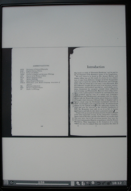

What I mean by 'a scanned book (double pages, not centred)' is like the image which is hopefully attached to this post!
I have that working perfectly now with odd/even setting. Let me know if you need further details.
Regarding the bug problem, I've left an answer on that thread. I can reproduce the one as described by Randy11, though it only affects scanned pdfs, not standard pdfs. With regard to the further bugs you mention, I can't envisage the kind of document you're working with or what you're trying to achieve - could you post some images?
Yes, that's what I assumed. Do I understand you correctly that you use the odd/even setting so that the pdf reader displays the two parts of the double pages separately, first the page on the left, and then after a click the page on the right, so that each side / half-page completely fills the screen?
I don't see how that is possible with the odd/even setting and I'd like to know how you do it.
Let's start with the original book. Let's say, for the sake of simplicity, your original book has 20 pages.
Then you lay the book on the scanner and you scan the first image. This image will contain pages 1 and 2 of the original book.
The image is image number 1 and it will be page 1 in your pdf file.
Then you scan the next double page of the original book. The result is image number 2, which contains pages 3 and 4 of the original book. And so on...
The corresponding pdf file will look like this:
Page 1: contains original pages 1 and 2 of the book
Page 2: contains original pages 3 and 4 of the book
The ebook / pdf will have 10 pages, each of which contains two pages from the original 20-pages-book.
As I understand it, the odd/even setting works like this: It shows you a certain viewport for all odd pages of the pdf file and a different viewport for all the even pages.
So you could bring the pdf reader to show you only the left part of pdf page 1, in other words only original page number 1.
You simply tell the pdf reader to show you only the left side of all odd pages.
Then you tell the pdf reader to show you only the right side of all even pages.
But then it will show you only original page 4. You won't see original pages 2 and 3.
What I would like to have is that the pdf reader shows me the original pages 1, then original page 2, original page 3, and so on.
For that the pdf reader would have to show me
1. the left side of pdf page number 1
2. the right side of pdf page number 1
3. the left side of pdf page number 2
4. the right side of pdf page number 2
I don't see how that is possible with the odd/even setting.
Unless you change the settings each time you want to turn the page...
Could you explain step by step what you did?

Apologies for delay - been very busy. Actually while I found the odd/even feature worked initially (i.e. immediately after reinstallation of updates etc.), it soon began to be inconsistent in the ways that you describe, jumping pages and so on. Definitely a fault there. I can offer a solution of sorts in the interim:
i. Under preferred aplications, I have epub: PDf Reader; FB2: Cool Reader; chm: Cool Reader; Doc: Office Reader. (I have not selected 'Old PDF Reader')
ii. I open my scanned pdf book, double page layout as above
iii. Under page settings I reset margins; under 'Reading' I select 'Page Mode' and '100%' (zoom). This is just to ensure we begin in neutral position.
iv. Under page settings I select 'Universal Manual'. I then use the stylus to pull the box in close around my text (i.e. the one dotted square encompassing the two blocks of text that are the facing pages)
v. Under 'Reading' I now zoom 'To Height'
vi. Under 'Reading' I now select 'Comic Mode'
I can now use my arrow buttons to read my document one page at a time, with each single page filling the screen.
Generally this works perfectly, though it's been erratic on occasion. I don't understand the viewport (which may be affecting things). I also suspect that the proportions of the 'Universal Margin' that you draw affects matters. i.e. if the proportions are a little too wide in relation to height (or vice versa?) then the viewport is invoked (dotted lines across page) and you start to get page skipping. But this is only a hunch.
Hope it helps!

What I would recommend for scanned images is as follows:
1. Split two up scanned pages into separate pages when creating the .pdf.
2. Use Adobe Acrobat Pro or NitroPDF to create hidden text with OCR. This way the e-reader software will find the margins and be able to crop the page more accurately. I use this feature all the time and it works great.
Hope this helps you out. Let me know if you have any other questions.

Hi jbsavitz
Thanks for your helpful post - much appreciated. Most of my scanned books have been scanned double page in this way. Do you know if there is a (hopefully simple!) way to split pages that have already been scanned in this way?
Also, I don't have Acrobat Pro or NitroPDF. Would I need to buy the full version of NitroPDF to do what you suggest? If so, can you say a bit more about the process (creating hidden text with OCR) that you mention - is it complex? (if you've described the process in a different thread, could you point me to it?)
Many thanks for your help with this.

Double page scans can be separated e.g. using Scan Tailor: http://scantailor.sourceforge.net/ (you don't get a pdf in the end, but a whole bunch of tiff images - converting those to a pdf is really easy though)
You can OCR your books using google's tesseract-ocr: http://code.google.com/p/tesseract-ocr/ I use gscan2pdf whenever I want to OCR something using tesseract. But I guess, you are on Windows, so that's not an option. Unfortunately, I don't use Windows, so I have no idea how to use tesseract on a Windows machine to get decent results. (But maybe this works for you: http://www.paperfile.net/ - found via google...)
You could try <http://www.pdfscissors.com/>.
