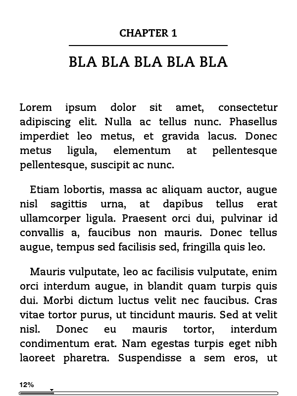

This trick can be useful for you but I think it doesn't work in ADE; in K4NT works perfectly. In your css stylesheet, write the following:
h2 {
   display: table; /*the key in order to get the top-line*/
   font-size: 1.4em;
   padding-top: 0.4em; /*here you control the gap between the text and the top-line*/
   margin: -0.35em auto 2em; /*the complement of the key*/
   border-top: 2px solid black;
p {
  font-size: 1em;
  text-align: justify;
  text-indent: 0;
p + p {
  text-indent: 1em;
.center {
  text-align: center;
.bold {
  font-weight: bold;
Now in your .html file write:
<body>
  <p class="center bold">CHAPTER 1</p>
  <h2>BLA BLA BLA BLA BLA</h2>
  <p>...</p>
  <p>...</p>
</body>
As you can see, the key is to display the text with the top-line AS A TABLE. And you center the table by applying margin-left and margin-right as "auto". With that you get what you want

Below you can see a screenshot of my Kindle and I attach the respective .epub.
Regards
Rubιn

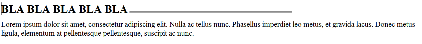

Hmmm, I don't know if this will work for you, but you can do a try. In your css stylesheet write:
h2 {
   font-size: 1.4em;
   text-align: left;
   margin: 1em 0;
   white-space: nowrap;
h2:after {
   display: inline;
   font-size: 1.2em;
   text-overflow: clip;
   word-spacing: -10px;
   content:" ————————————————————————————————————————————————————————————";
And in your .html file write:
<h2>BLA BLA BLA BLA</h2>
<p>.... something ...</p>
I really don't know if your reader can support the pseudo-element :after.
Regards
Rubιn

Old 06-09-2013, 08:26 PM   #9
Posts: 31,323
Karma: 62025226
Regards
Rubιn
Ooo!
Looked great in Sigil
then I sent it to my PEz (ADE based)
no line.
At least it did not barf and failed gracefully (unusual for this version)

Thanks, I'm using an iPad and it sort of works. Sigil displays it correctly, Calibre viewer and iBooks display a series of dashes ie — — — —
The good thing is it works on chapter One ———— and on Twenty-Three ———— just as well and the lines don't flow through to the next line.
I added a font-size: to the h2:after to reduce the thickness of the em dashes.
