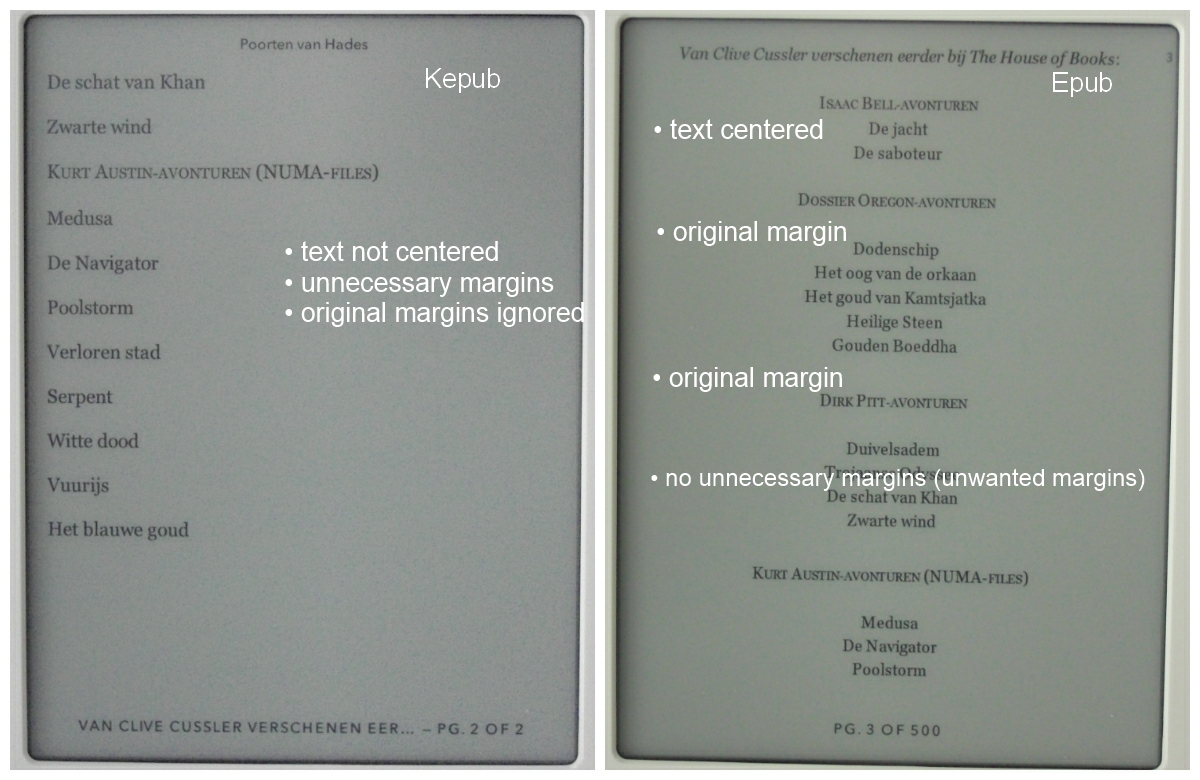

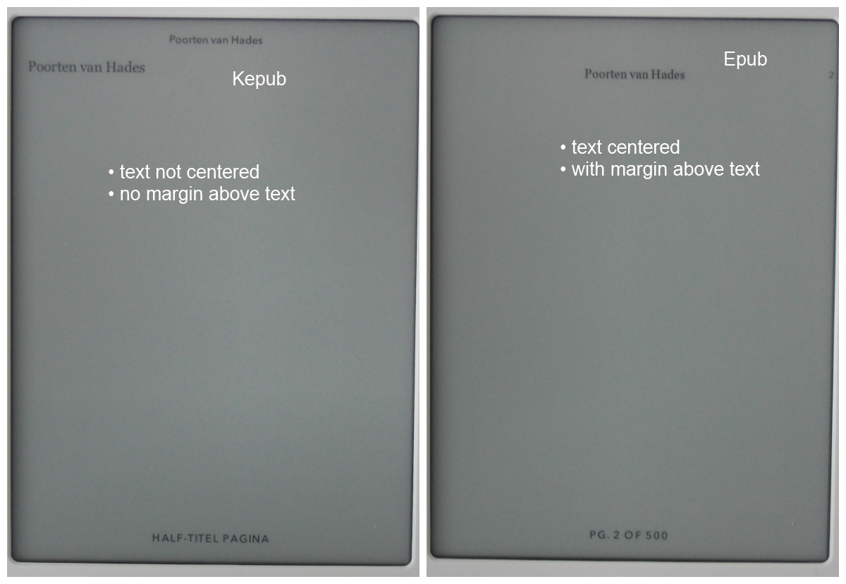

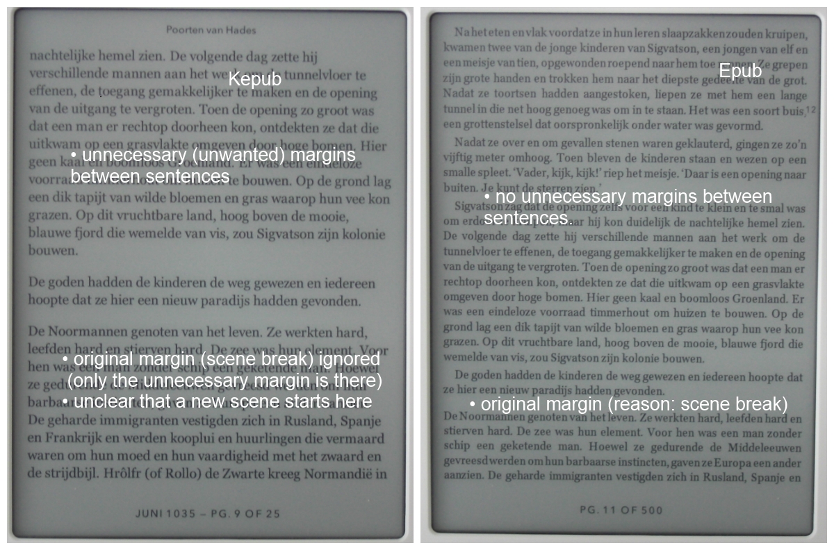

Some issues:
• unnecessary margins between sentences. Adding a padding feature (padding left-right and padding top-bottom) to the font settings may fix this. Default padding should be zero.
• the necessary margins (scene breaks) are not there (or not recognizable as such)
• centered text is not respected
• font issues
• “double” page margins (epub page margins + margins of the kobo wrapper)
• … (yes, there are more)
See attachments for a side-by-side comparison.
Unnecessary margins between sentences may be solved by adding a padding feature (padding left-right and padding top-bottom) to the font settings. Default padding should be zero.

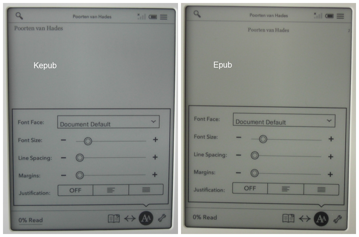

If you set Justification to OFF in the font menu, the device honors the alignment settings of the kepub, at least for text (I never tried with pictures). Or has this changed with 2.5.1?
Maybe it would be helpful if you use a book for demonstration that you can upload..

All settings are default for both kepub and epub (no manual changes have been made). The pictures are taken from an original kepub and epub downloaded from Kobo.
The original text alignment is justification. Justification is OFF.
As far as I know centered text never worked properly in kepubs. It is not an issue that suddenly popped up in 2.5.x.
In user generated kepubs (renaming epub to kepub.epub) you can fix this bug by adding two text-alignment settings to "reset" or "force" text-alignment.
body {
margin:0;
text-align:right; /* force change or reset of text-alignment*/
font-family:serif;
text-align:justify; /* the preferred default text-alignment */

If I select Justification OFF, the OFF button has a very dark color. Therefore I thought yours is not set to off. However, on my Touch, one of the three justification buttons is always dark. Maybe this is connected with settings in the Kobo eReader.conf.

Maybe its working with some kepubs and I don't have any idea why it (sometimes) breaks.
I usually read sideloaded epubs (the images in the first post show why).
But this center align issue is not an isolated case. I have many bought kepubs (I said all, that might not be completely true; but I'm not gonna test it on every kepub I own) that have this issue.
Manually flipping the text alignment settings in the font menu sometimes fixes this (basically the same procedure as hardcoding the css as I mentioned in a previous post).
But this doesn't work with this kepub (and some others aswell ).
Why? I do not know.
