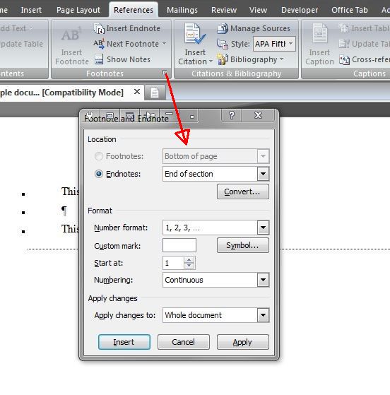

@BeccaPrice - If you mean links within the document itself then :
Word 2007 documents saved as Filtered HTML which I then Calibre convert to EPUB work fine for me, including the footnotes and endnotes, with their links, - simple sample attached in doc, zip and epub formats.
Because an ebook is by definition unpaginated, Footnotes always land at the end of the document, so I only use Endnotes - so what I see in Word is more or less what I see in the EPUB.
McKinsey have recently started to publish some of their documents in EPUB and MOBI - in addition to PDF. AFAIK McKinsey's use Word, but they don't publish in Word. They are putting the 'notes' at the end of sections - maybe you do that by configuring Foot/End Notes (see attached screen shot). Here is a recent example - Financial Globalisation: Retreat or Reset
You can convert & swap foot and end notes with the Convert button in the Word foot & end note configuration dialogue.
If you mean external links within a note to Web Pages etc - then that's a different can of worms - including web site redesign, which can render all links "404 dead" - Bundesbank, CFTC etc
