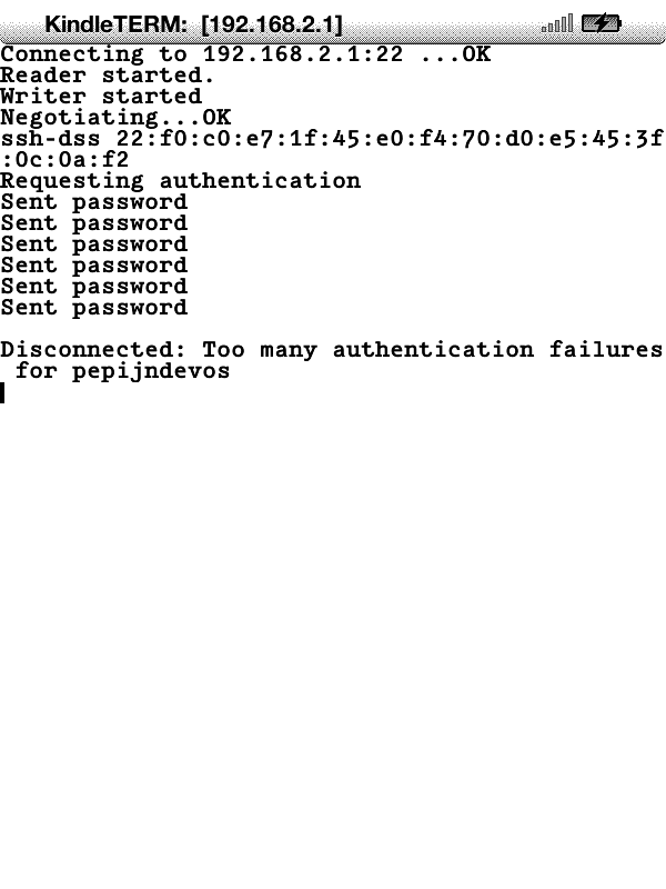

Ok, I tried to install this kindlet on my kindle. It seems to work, with a few issues:
The screen is initially blank. Pressing a few buttons reveals the input fields.
I can SSH into root@localhost, which is useless without a keyboard.
I cannot SSH into my machine. Any ideas? Maybe I'll try public key authentication.

i find exactly the same, i think it's a ssh authentication/key issue, but i don't know how to get past it.
i just got a different kindlet version working on my k4, with a remote keyboard window on my computer - here
