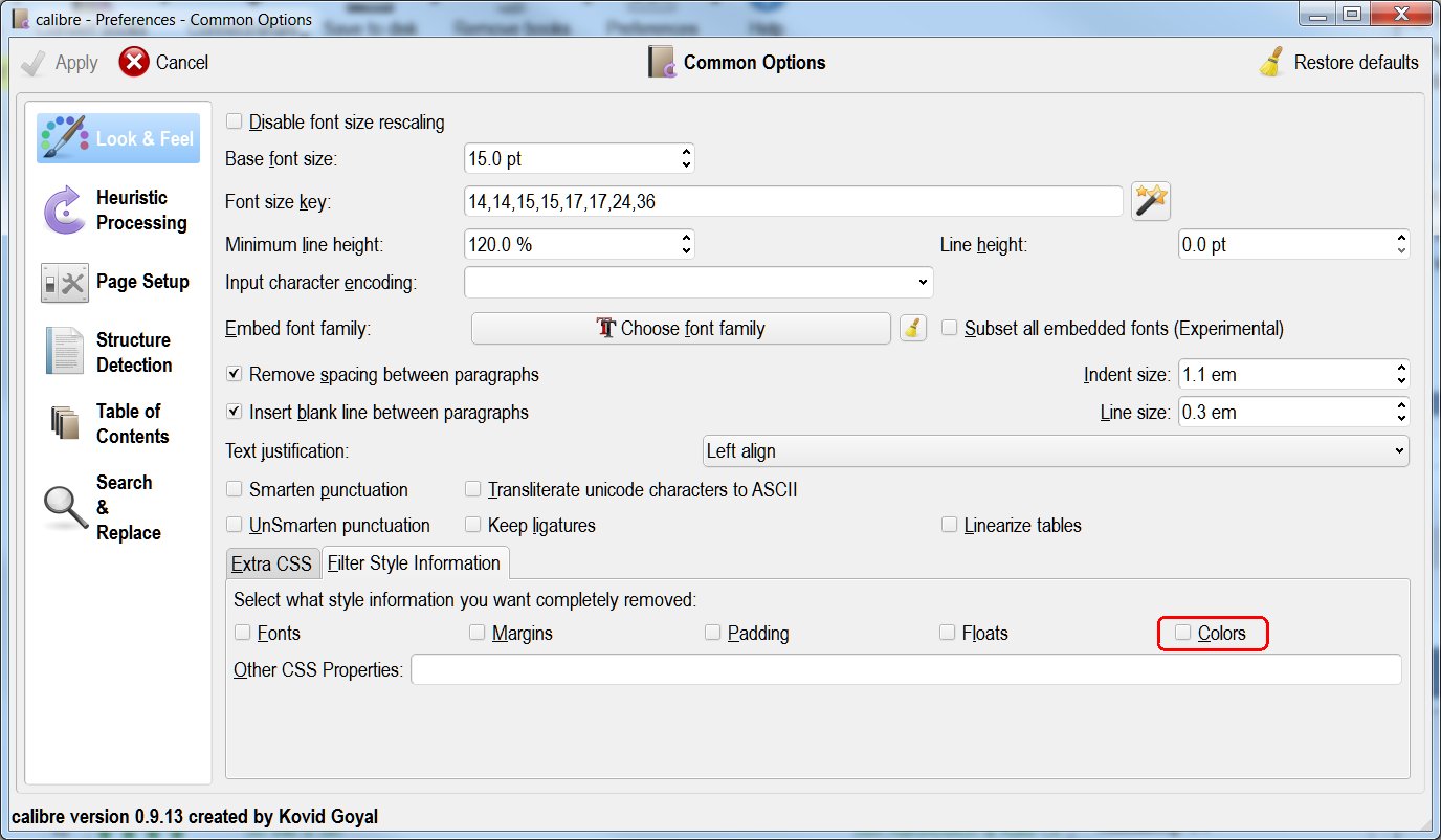

Go to Preferences - Common Options - Look & Feel - Filter style information tab and check the colors box. Checking this box should remove should remove all color attributes during conversion.
During conversion check this box and ensure it is checked because reconverting books will use the previous settings unless told otherwise.
