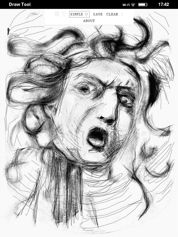

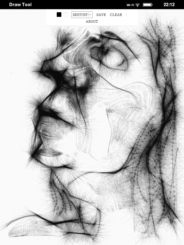

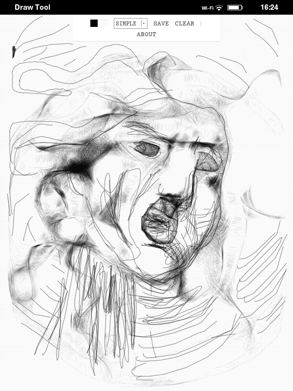

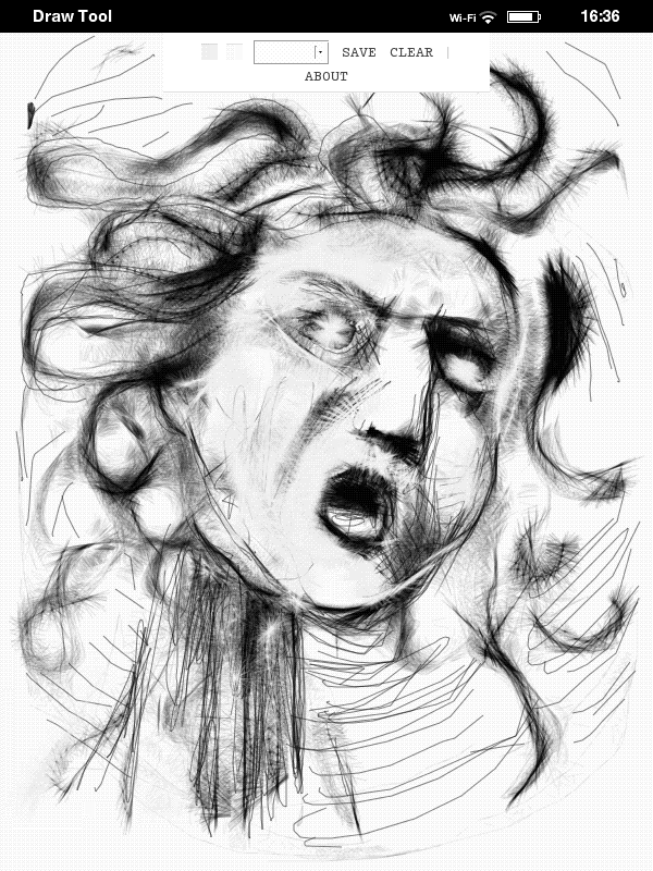

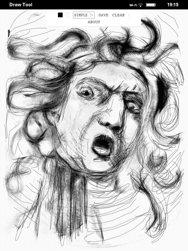

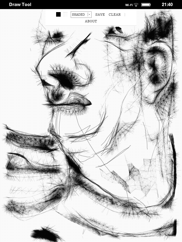

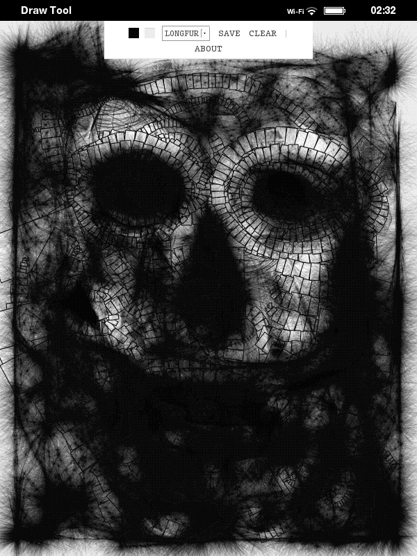

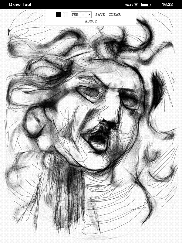

Hi everyone ,
I'm starting this thread because of some lack of information on this Draw Tool.
Since it looks really great, and open a whole new funcionality for the kindle touch concept, I think it's a good point to keep it up.
First of all , Draw Tool appeared for me on Launcher , after installing Titano's gui laucher extensions, about the submenu [hidden features] .
It worked really great and accurate on KT , recognizing including pressure.
As I work with draw and graphics, I love the possibility of turning the Kindle Touch on a Sketchbook aswell . This idea really catches me since I heard of that badasss NoteSlate concept that made some noise last year ...
The e ink contrast is greeeeat for draw , as it looks really material like you're drawing with graphite!
Sad that, I came trough some doubds, that I share here as a debug possibility;
1-
I can't save anything on KT port of the tool from the [save] button .
2-
Just contrast wheell , info , line options and clear are acessible for me at this moment
3-
I can't make a screenshot from inside the tool aswell , seems pressing home will make me get out of the tool ... - [[ How could I get a screenshot on this ? I tried the told way - Home for 2 secs + tap ... - could someone be more instructive here ? maybe I didn't get it right... ]]
4-
After multiple shots of trying to get a screenshot , and after other members talks , I found the tool developer's website with the live tool here http://mrdoob.com/projects/harmony/
I know it maybe is a hard issue , but who knows ? Maybe someone have any answer...
As I'm no developer at all , I leave my short experience on this , here and ask for suggestions, help, or a focus on this, as I think many others would love that as me !
Thanks all mobileread crew!
See ya !
UPDATE
Solved the screenshot issue for the moment with titanosīs gui launcher update as you can see down here and here https://www.mobileread.com/forums/sho...d.php?t=185562
Thanks Everybody!

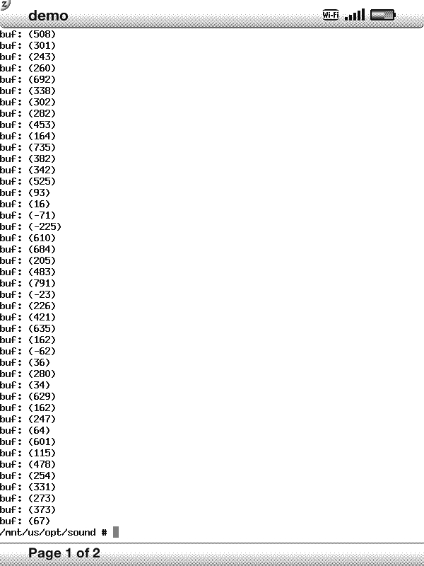

itīs not so tough.
Originally Posted by TulseLuper View Post
geekmaster ,
For the moment working with the framebuffer is bit to raw for me ... lol
I canīt do much with anything RAW thatīs not a DSLR ... hehehehe ...
Seems for this Iīll have to wait some more
But thanks anyway and letīs wait for someone who can work this out for mortals ...
See ya !!
You should check the link itīs pretty easy
mkdir ~/GIT
cd ~/GIT
git clone git://github.com/dpavlin/k3libre.git
(if you dont have it sudo apt-get install git) then repeat the last step
output:
twobob@dev ~/GIT $ ls
k3libre
cd k3libre
now nano ~/GIT/k3libre/pdf2fb.sh
and edit the line
./pgm2fb.pl page-$page.pgm | nc 192.168.x.xxx 8888 || true
putting your kindles IP where the Xīs are.
and do the same for ~/GIT/k3libre/ssh-screenshot.sh
and edit the lines
landscape=`ssh root@192.168.x.xxx cat /sys/module/eink_fb_hal_broads/parameters/bs_orientation`
and ssh root@192.168.x.xxx dd if=/dev/fb0 > $name.fb
with the same info.
Couple of caveats,
You will need the access via SSH working to the kindle.
You will need to know the kindles IP in advance, a fixed one in the router is not a bad idea.
Usage: ssh-screenshot.sh
This is from memory, Iīll go check my facts. EDIT: Yep just did this from a virgin install.
Unsure if I had to copy anything to kindle but a quick look at the code seem to indicate an nc call and an eink call, which are both native.
Hope this helps someone.
SIDE NOTE:
I edited my /etc/hosts to simply contain 192.168.x.xx k (this is actually what the OP has set up on the dev box) this is also helpful and you can replace all the ugly IPś with k
One more point. A link to the script is also handy I made one called kss for kindle screenshot.
Looking through the stuff in the REPO you can trigger this via launchpad amongst other functions but this should get you going.
It generally fires up ImageMagick or similar to handle the file, you save it yourself.
EDIT: ADDED XTRA PIC

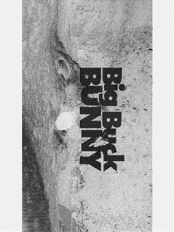

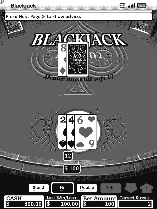

The quality is WYSIWYG mainly....
In the main it is WYSIWYG.
however some apps like say - err - mine *blush* are a bit cheeky and wash images across the screen utilising the artifacts to their own ends.
others use dithering to the same effect...
Still others just dump their stuff direct...
YMMV but if you work at it you will probably wangle decent results.
Images Attached.

The dithering looks horrible on a light-emitting display such as CRT or LCD (as expected) because the gamma is all wrong. It looks MUCH better printed on paper or displayed on eink (especially for MOVING images where your eye follows the motion and the dithering gets mostly "averaged out"...

Yes I should add that the movie and graphics looked NOTHING like that at all, They looked really good
and the video streaming tech is courtesy of GM - TYVM : )
Images Attached.
Cool !
I can see this grain issue . Looks a lot different . If you could possibily take 2 screenshots of the same image from the two diferent ways it would be even better!
Maybe tomorrow iīll read better on how to do this . must be great on draw tool since the tracing itself comes from an calculation maybe like vector ... this would be great for strokes !
see ya

Some screens tests from draw tool
and yes ! as you can follow back on this thread we figured out a way to get those screenshots alive on KT!
ID:	89639   Click image for larger version
ID:	89640   Click image for larger version
ID:	89641   Click image for larger version
ID:	89642   Click image for larger version
