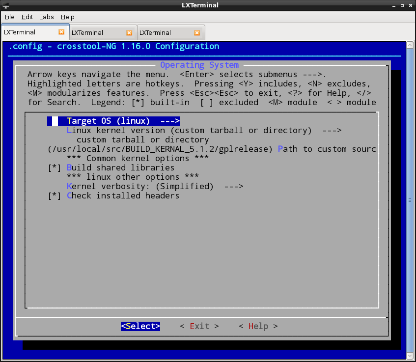

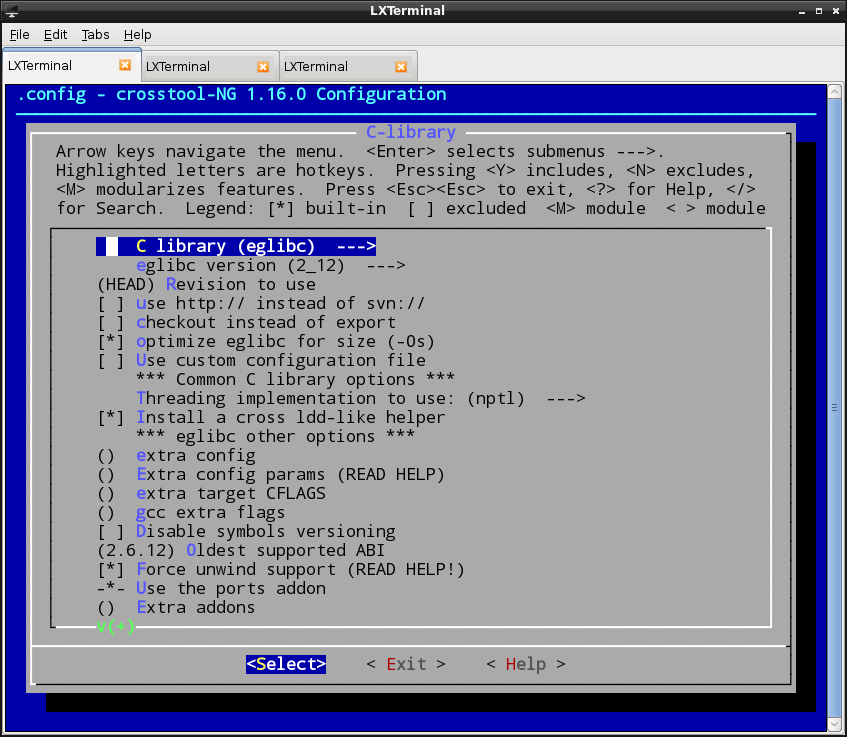

So. I fired up make ctng-menuconfig.

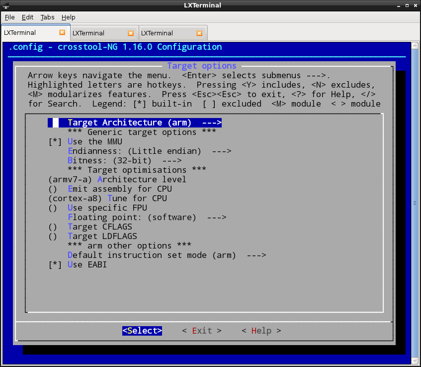

selected 32bit little endian Cortex A8

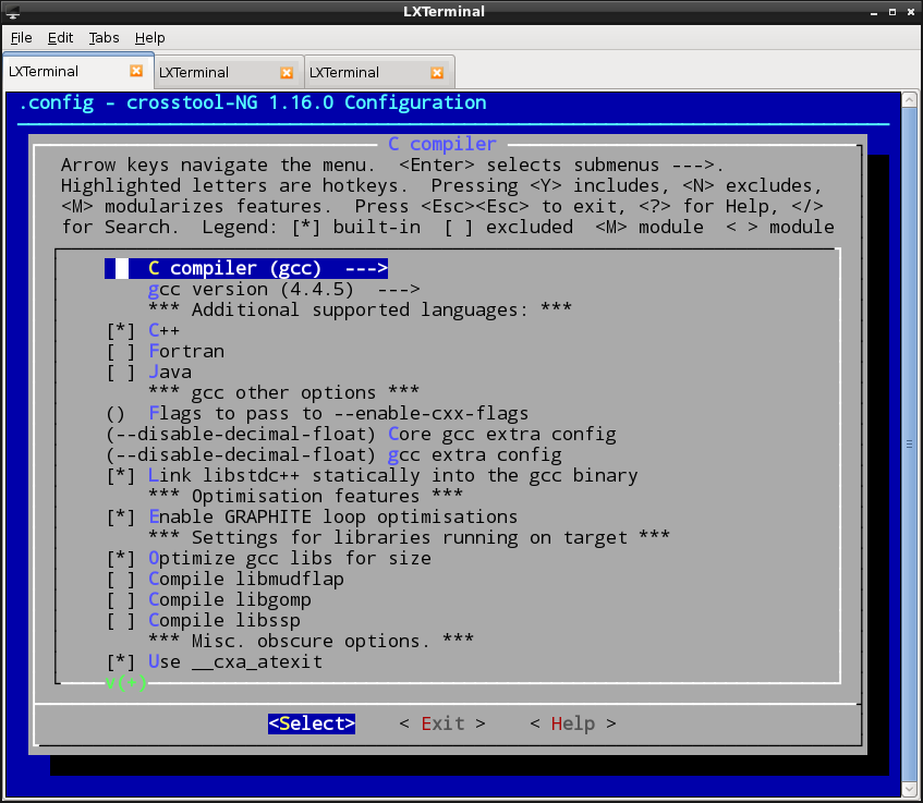

GCC 4.5.4
eglibc 2.12
all the settings outlined in https://www.mobileread.com/forums/sho...6&postcount=17
and pointed it to a custom folder for my kernel /usr/local/src/BUILD_KERNAL_5.1.2/gplrelease
(setup the other stuff to sensible defaults)

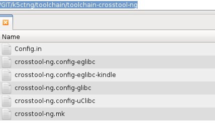

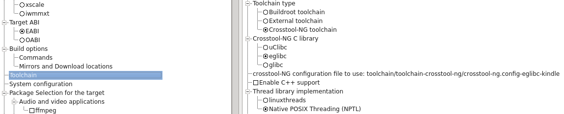

I also then saved out the .config file to
~/GIT/k5ctng/toolchain/toolchain-crosstool-ng folder as a custom -kindle named config file for future reference.
.config was from here
~/GIT/k5ctng/output/build/build-toolchain/.config
and then run a make.
all software is not enabled, nor is busybox etc...

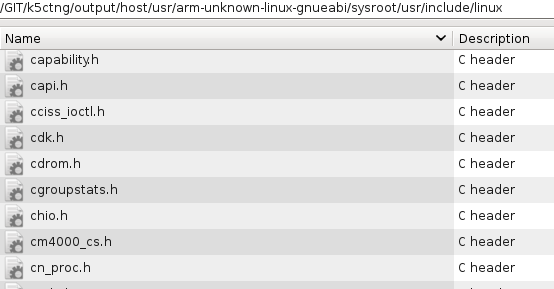

[ALL ] ~/GIT/k5ctng/output/host/usr/arm-unknown-linux-gnueabi/sysroot/usr/include/linux/fsl_devices.h:23: included file 'linux/cdev.h' is not exported
[ALL ] ~/GIT/k5ctng/output/host/usr/arm-unknown-linux-gnueabi/sysroot/usr/include/linux/mxc_pf.h:53: found __[us]{8,16,32,64} type without #include <linux/types.h>

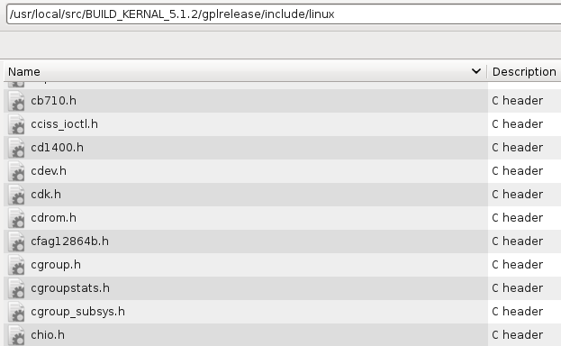

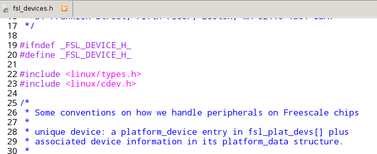

the file is indeed not exported (pictured) to
~GIT/k5ctng/output/host/usr/arm-unknown-linux-gnueabi/sysroot/usr/include/linux
it (cdev.h) does exist in the kernel sources however.
so I guess my question is in order to fix such an error am I to use an #ifdef something ?

how does one make kernel headers install correctly in this instance then?
eink.h for example. is it simply a case of copying them across?
much obliged.

@twobob: Well, there's probably no eink.h in the mainline kernel, so... .
AFAIK, every project that wanted to rely on it bundled a version of it in their own project's includes. That might not be pretty, but it works .
If you plan to use it in a more widespread manner, putting it in the proper place might be a cleaner solution, but you'd have to use lab126's kernel, or patch mainline. (And given your experience with the first choice, it might *also* imply taking a hammer to some makefiles to fix it ^^).

checking installed Linux kernel header files... 2.0.10 or later
[CFG ] configure: WARNING: minimum kernel version reset to 2.6.16
[CFG ] checking for kernel header at least 2.6.16... ok
[CFG ] running configure fragment for ports/sysdeps/arm
[CFG ] checking whether the CFI directive .cfi_sections is supported... no
[ERROR] configure: error: need .cfi_sections in this configuration
[ERROR]
[ERROR] >>
[ERROR] >> Build failed in step 'Installing C library headers & start files'
[ERROR] >> called in step '(top-level)'
[ERROR] >>
[ERROR] >> Error happened in: CT_DoExecLog[scripts/functions@172]
[ERROR] >> called from: do_libc_backend_once[scripts/build/libc/glibc-eglibc.sh-common@347]
[ERROR] >> called from: do_libc_backend[scripts/build/libc/glibc-eglibc.sh-common@143]
[ERROR] >> called from: do_libc_start_files[scripts/build/libc/glibc-eglibc.sh-common@60]
Which I "understand" to be reference to arm debugging symbols.
EDIT: I'll step back to glibc2.11 and see what happens then
[EXTRA] Removing access to the build system tools
[EXTRA] Removing installed documentation
[INFO ] Cleaning-up the toolchain's directory: done in 1.15s (at 22:19)
[INFO ] Build completed at 20121016.174411
[INFO ] (elapsed: 22:18.62)
[INFO ] Finishing installation (may take a few seconds)...
YAY

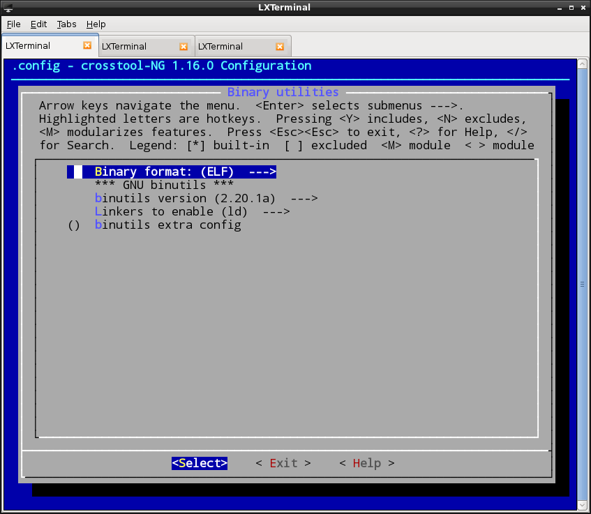

@twobob: That seems to imply that you're using a binutils version too old to build this libc. (FWIW, I'm using 2.22).
Old 10-16-2012, 01:49 PM   #12
twobob
( ͡° ͜ʖ ͡°){ʇlnɐɟ ƃǝs}Tır
twobob's Avatar
Posts: 6,586
Karma: 6299993
Join Date: Jun 2012
Ah thanks.
2.20 I believe. glibc2.11 builds okay with binutils 2.18
I could drag it forward a spot then... and try 2.12 next then
I misnamed my tuple (oops) so it will have to wait 30 mins or so
while I do a quickie rebuild and test.
EDIT: Okay, retrying with 2.20 now... and 2.12 - Fail
Retrying with 2.21.1 and 2.12
