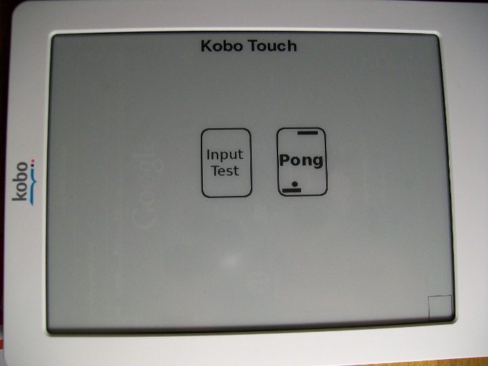

I recently managed to get python and the pygame module working on my Kobo Touch.
So I whipped up a couple of quick examples, and I put them, along with python and
pygame, in a KoboRoot.tgz file. Here's a download link.
Install it by extracting the zip file and copying the KoboRoot.tgz file to the .kobo
folder on your Touch. Now telnet into your Touch and run:
ln -s /mnt/onboard/.python/bin/python /usr/bin/python
To start the examples, just do:
python menu.py

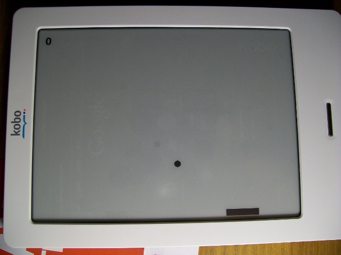

Pressing the Kobo's home button when running an example will take you back
to the example menu. In pong, the power switch will flash the screen.
As would be expected, pygame has a couple of problems on the Kobo.
  • Sometimes pygame will hang when trying to start its display. When this happens,
    pressing CTRL+C seems to snap it back into action.
  • The refresh rate of the e-ink is pretty bad. I know it can do better, the web browser
    can display black-and-white animated GIFs quite well in partial-refresh mode.

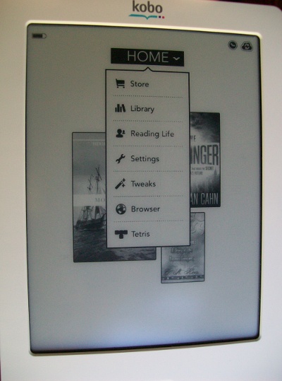

I figured out how to restart nickel without rebooting the Touch, so Tetris can now
be started from the Kobo's home menu using ah-'s plugin interface!
The plugin, with an updated version of Tetris, can be downloaded here.
Extract the file and copy KoboRoot.tgz to the .kobo directory on your Touch.
You must open the library once to start the plugin.
Pressing the home button or pulling the power switch will end the Tetris game
and send you back to the Touch's home screen.
This is HIGHLY experimental, and things might not always work right!

Kevin, doesn't work for me. No Tetris and no Tweaks. No errors either.
I'm back to the original Tweak...

quek1982
quek1982 began at the beginning.
quek1982's Avatar
Posts: 8
Join Date: Jan 2012
Location: Le Havre, France
Device: Kobo Touch
ok for me
install first ah-'s plugin interface
then tetris kobo plugin
quek1982 is offline   Reply With Quote

Which firmware version are you running? Did you get the "Installing" screen
after copying KoboRoot.tgz to your Touch? I just did a factory reset on my
Touch, upgraded to 1.9.17, and then installed my Tetris plugin with no problems.
Originally Posted by quek1982
ok for me
Installing ah-'s plugin interface first shouldn't be necessary, since my plugin will
just overwrite ah-'s.

I tried it again, it did not work. I saw the installing screen, but after that my before installed tweaks were gone but nothing new, no tweaks, no tetris.
Firmware is 1.9.17 with telnet enabled.
Installing the "normal" tweaks works fine.

hello.
to get it works i needed to:
1-factory reset the kobo
2-upgrade to 1.9.17 firmware
3-install lastest tweaked interface
4-install tetris.
it's realy works great for an e-ink reader.
i would be great to add more game adapted to e-ink (chess game, go game, reverso, sokoban, all puzzle like ^^)
thanks for your works !
