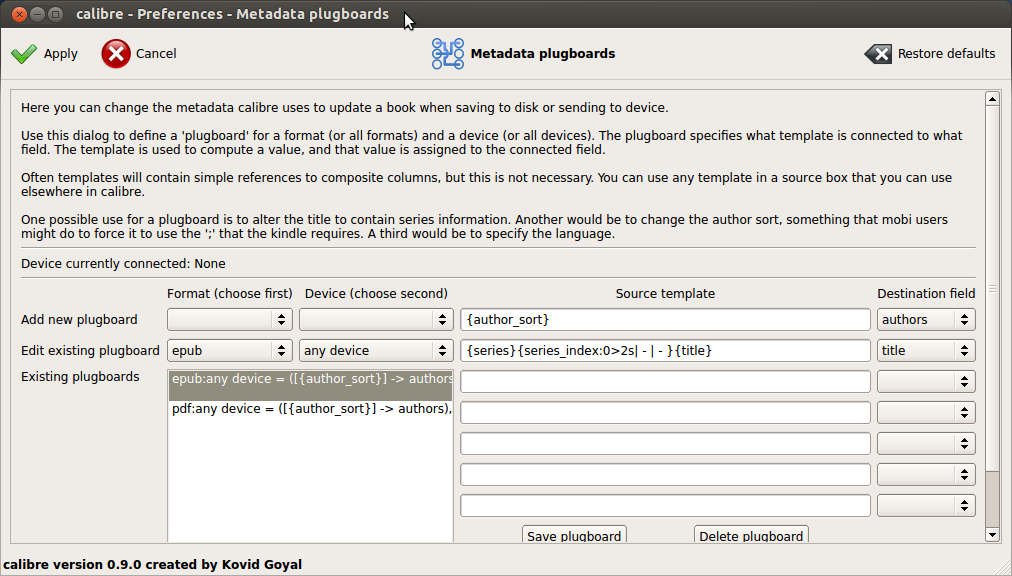

Ah... Then I think I understand better.
I used to have the same problem. But by using a Metadata Plugboard I could fix it.
By using a Metadata Plugboard you can change a field to another on the fly, while you send books to your device. For example you could change {authors} to {author_sort}, and that way your device will sort correctly.
I also added information about series to the title.
Name:	Skärmbild från 2012-09-29 15:13:07.png

thank you
thank you
with the example , it was easier for me
have a good time
