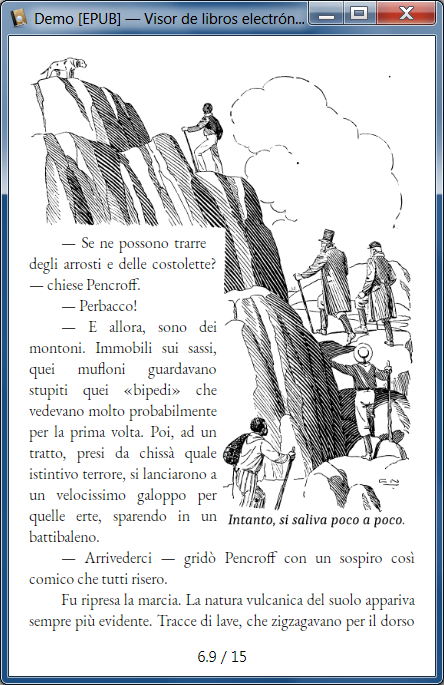

I'm digitizing a book for my personal use and I'm having some trouble with the use of clip-path and shape-outside properties. In the book there are non-rectangular images such as this one, to which the text adapts:
After studying various possibilities (like splitting the images in 2 parts) I decided to make an EPUB2 file with two EPUB3 extensions, clip-path and shape-outside for the pictures, so that updated readers would show the text framed and EPUB2-only readers could still read the file.
The problem I have is that in the Calibre Viewer the text is framed only in Flow mode, not in Paged. The same in Lithium for Android.
Does anyone know what I might be doing wrong? I attached a chapter as a demo. Thank you in advance!

I do not know enough about how those reading platforms work to understand why this does not work correctly in paged mode.
I did notice from a bit of testing that it works better, but not perfectly, if the caption below the image is left out.

Yeah, another thing I noticed is that the text reflows around the caption, but not around the picture... this would point towards a problem with the CSS, or maybe with the viewer implementation, who knows
I might try asking on the calibre bug platform, but it's like that in other apps too

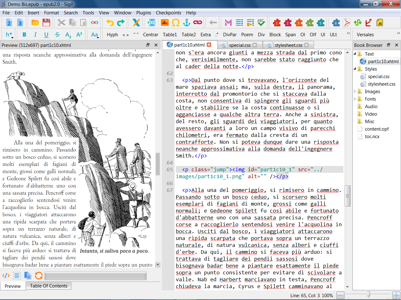

First at all, don't use the clip-path property. You can, but is easier to rest ONLY in the property shape-outside. And since you are using .png images, better yet.
The main drawback is also to have a caption with the image, but if you add the text to images, then all issues are solved.
Do the following:
1. Open your .png images in a image processor (Photoshop, Gimp, etc.).
2. Convert your images to RGB.
3. Add an alpha channel to your images (in Gimp, Layer>Transparency>Add Alpha Channel).
4. After that, select the regions (or region) of the images to be filled with text (no matter the shape of the regions, triangular, rectangular, in star shape, whatever).
5. Once you have selected the regions, you must make them transparent. In Gimp, Layer > Transparency > Color to Alpha.
6. Done with Layer. Now if your images have captions, add the respective text to them with the Text tool of the image processor.
7. Save the images and load them in Sigil.
Now, in your .xhtml file, write the following:
  <p>Dal punto dove si trovavano, ... neanche approssimativa alla domanda dell'ingegnere Smith.</p>
  <p class="jump"><img id="part1c10_1" src="../images/part1c10_1.png" alt="" /></p>
  <p>Alla una del pomeriggio, si rimisero in cammino. Passando sotto un bosco ceduo, si scorsero molti ... e Pencroff esclamò additandoli:</p>
And in your .css stylesheet write:
#part1c10_1 {
    width: 100%;
    float: right; /* This property is very important, even with a width of 100% */
    margin: 1em 0 0;
    shape-outside: url("../images/part1c10_1.png");
    shape-margin: 5px; /* Of course, you can change this value */
That's all. Now you have the text with the design you wanted: in Sigil, Calibre (in paged mode), Lithium, PocketBook, Gitden Reader, Reasily and any app based on Webkit or Readium.
However take into account that you are working under epub2 and epub2 doesn't support the shape-outside property. You should work under epub3. If you are going to use images only in L-shapes (or inverted L), there are other ways to get that effect for epub 2 (and only with css2.1 properties).
See how your epub looks under Sigil and Calibre:

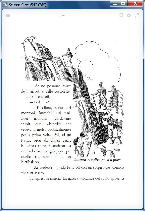

And here you can see how it looks under Readium, BibiReader and EpubJSReader:
ID:	188126 Click image for larger version
ID:	188127 Click image for larger version
I also attach a new epub so you can watch better how the code works.
