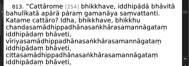

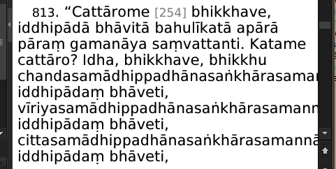

OK, here's the code for an example:
<p class="bodytext"><a id="para813"></a><a id="para813_sn5"></a><span class="paranum">813</span>. “Cattārome <a id="T5.0326"></a><a id="V3.0328"></a><a id="M3.0222"></a><a id="P5.0254"></a><span class="pn">[254]</span> bhikkhave, iddhipādā bhāvitā bahulīkatā apārā pāraṃ gamanāya saṃvattanti. Katame cattāro? Idha, bhikkhave, bhikkhu chandasamādhippadhānasaṅkhārasamannāgataṃ iddhipādaṃ bhāveti, vīriyasamādhippadhānasaṅkhārasamannāgataṃ iddhipādaṃ bhāveti, cittasamādhippadhānasaṅkhārasamannāgataṃ iddhipādaṃ bhāveti, vīmaṃsāsamādhippadhānasaṅkhārasamannāgataṃ iddhipādaṃ bhāveti. Ime kho, bhikkhave, cattāro iddhipādā bhāvitā bahulīkatā apārā pāraṃ gamanāya saṃvattantī”ti. Paṭhamaṃ.</p>
Here is a screen shot in ADE with the page stretched wide enough so all the long words fit...
And this is a shot when I make the page more narrow, simulating a smaller screen (note, I'm just changing the viewing window size). You can see that the fifth, seventh and ninth line run off the screen.

If the word cannot fit on one line, it will run off. It will not hyphenate. ADE will have no choice than to let the word run off.

Wrapping is worse in my opinion. The break is guessed and is very strange. Then again, I cannot imagine too many words that would be longer than a line.
ADE does display the rest of the line, it is only not visible.

Newer ADE versions, like the 1.8 preview (is it still a preview? is it still available?) or the embedded versions in newer readers can hyphenate. It's not a perfect feature (my reader will sometimes leave a single letter in a line, or insert a hyphen between a letter and a punctuation character), but it won't allow words to overflow a line.
Or you could use a zero-width space (& #8203;), but that's inserting special characters.
Some languages make heavy use of compound words. It's not extremely common to have words that long, but it does happen.
You might want to make a note at the beginning of your book asking the reader to switch their book view to landscape, if that is possible on the Kindle. That is, they would hold and read their book with the longest screen dimension horizontal. That will allow longer lines. If editing for epub, also make sure you pull out all non breaking spaces to avoid compounding the problem of overlong words.
Actually, the Kindle just wraps the line if it is longer than the screen width. Since I personally use a Kindle, this is the behaviour I am accustomed to. It was when I used a Sony Reader that I saw the problem with long words not displaying.
Removing any non-breaking spaces is a great idea.
Thanks everyone.

What language is this? It'll be a problem in any "agglutinative" language which forms sentences by joining words together. Turkish is perhaps the most commonly encountered (for a European, anyway) agglutinative language.
Old 08-20-2012, 09:25 AM   #15
BKh
BKh can extract oil from cheeseBKh can extract oil from cheeseBKh can extract oil from cheeseBKh can extract oil from cheeseBKh can extract oil from cheeseBKh can extract oil from cheeseBKh can extract oil from cheeseBKh can extract oil from cheese
BKh's Avatar
Posts: 107
Karma: 1000
Join Date: Mar 2011
The language is Pali, the scriptural and liturgical language of Theravada Buddhism.
